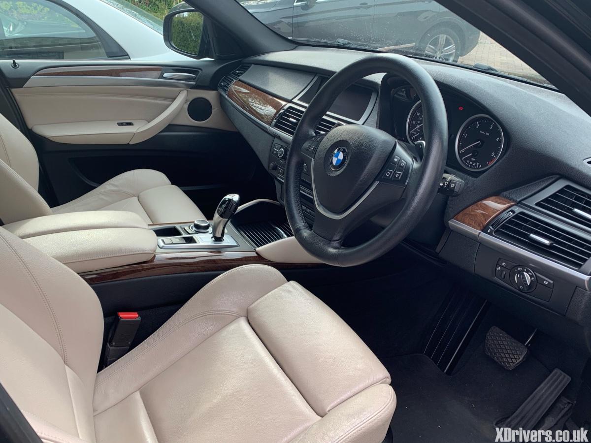

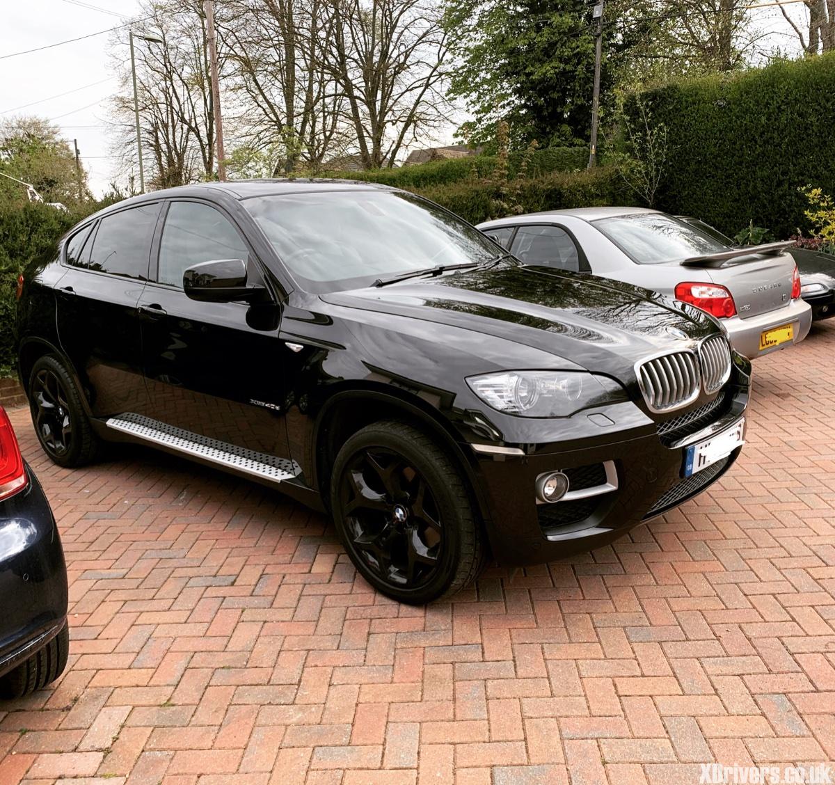

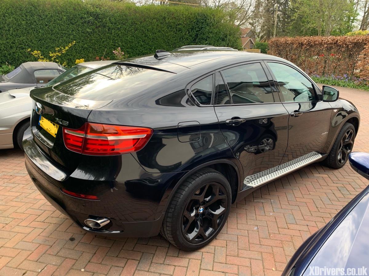

Been trying to find a decent owners forum for the X6. It doesn’t seem to get much love on Pistonheads and most forums seem fairly quiet before I found a link to here.
Just purchased a 2014 40d from the original owner with 60k and full BMW SH. Got it for what I think was a good price as it does need 2 front tyres, oil service and an MOT at the end of May.
