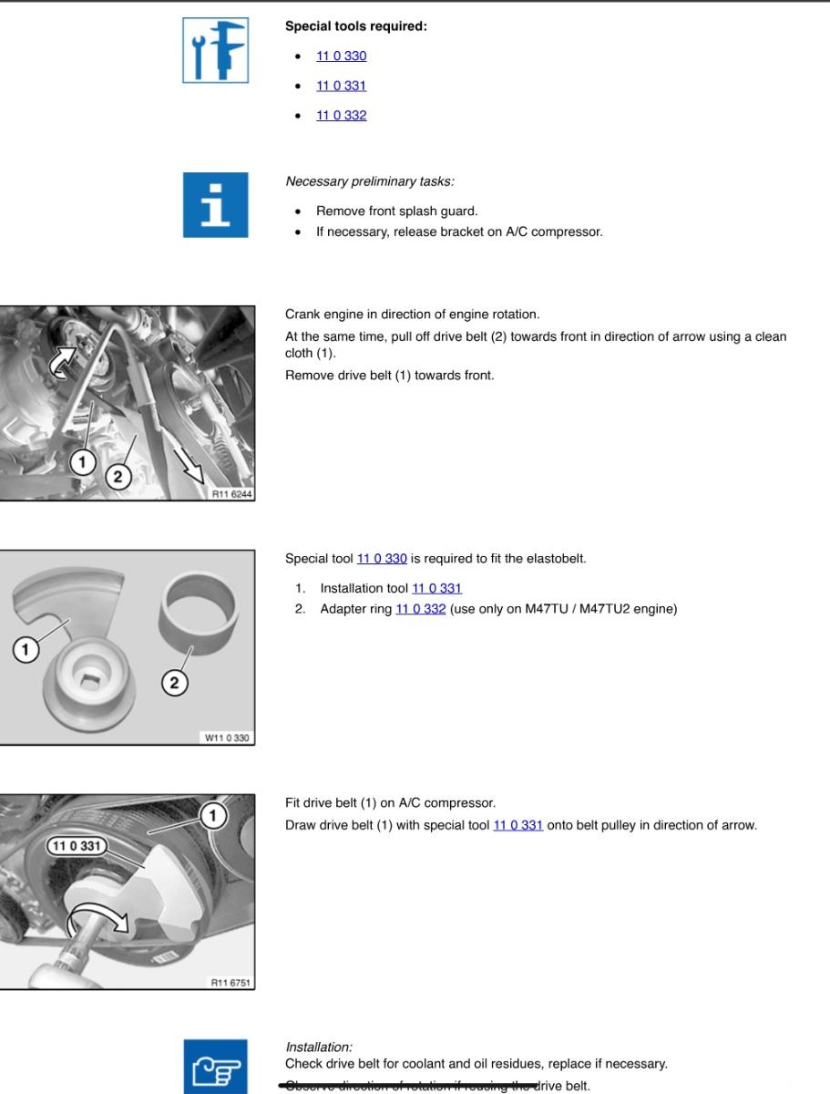

This help?
Looks like you need something to stretch the belt slightly to get it over the pulley?
Bottom comment states to refit the old belt the same way around as it came off.

I do like Amazon Prime, emergency tools needed to sort car, both delivered next day.
Needed a socket to fit the bizarre crank arrangement, 4off male torqx bolts. Then a magnetic stretch tool to fit the stretch belt. Ridiculous design with a Steeler mentality!
