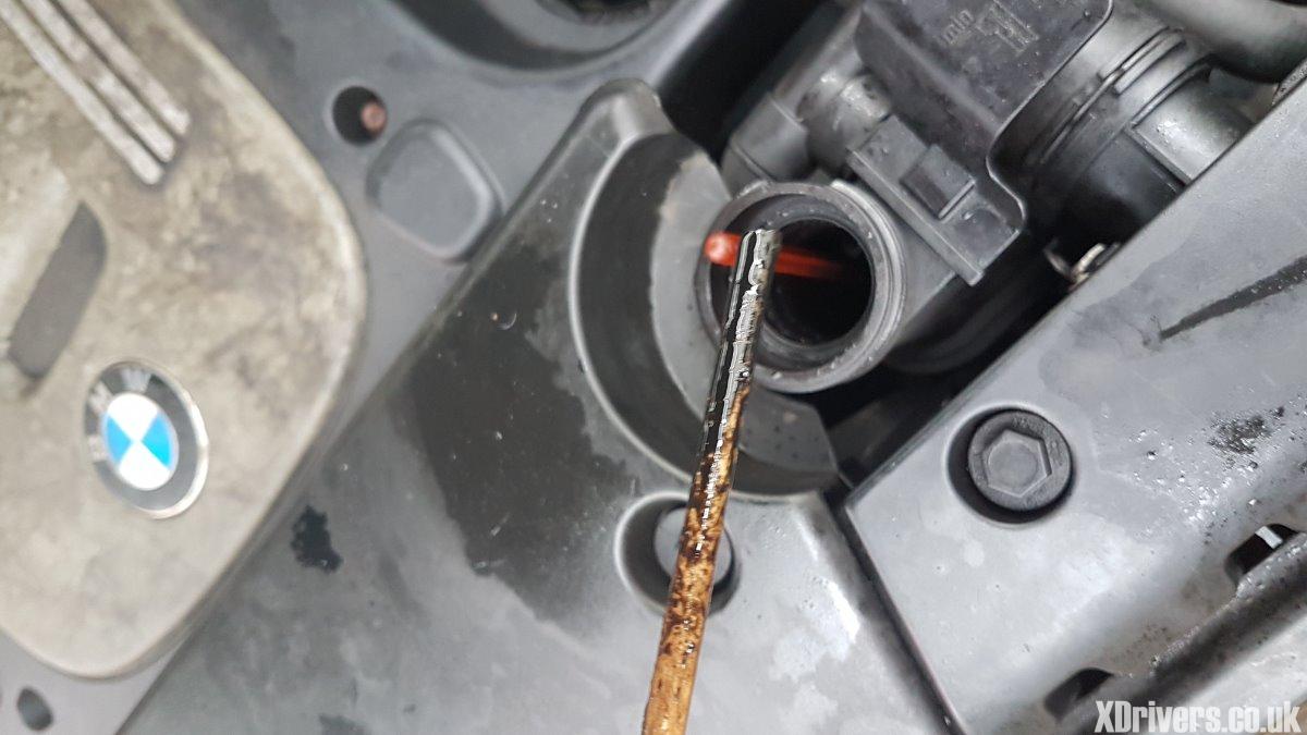

I got the car transported to a Halfords who said that they could flush it as many times as necessary to get rid of the oil. I gave them some Wynns Radiator flush as well to help. They flushed it with the Wynns and 3 further water flushes. On collection, they said that they got rid of most of it but can't completely get rid of all the residue black surface oil in the radiator reservoir. After driving the car 0.5 miles, I pulled over where I could find something to dip in the radiator to check quality. What I found was that the radiator coolant level was at the bottom and there was still really thick oil evident. I turned around and went straight back to Halfords. They said that the water just needed topping up and got a watering can. I said that I was concerned whether the job had been done properly as it's still so black. They showed me the vessel that they had done the flushing into and it was about 25 litres of what looked like black household radiator water. They said that they use a pressurised flushing system, so don't need to bleed the system but there may have been a small airlock which is why the level was low. They were confident that there was no problem with the car.
Not impressed but satisfied that it must be driveable I took it home. I took the attached photo of the reservoir and a stick that I used to dip into the reservoir after the flushing. To be fair, prior to the flushing the stick came out as thick black, whereas after flushing it's got areas where the oil hasn't stuck. Meanwhile, both the coolant and the engine oil caps have never shown any signs of emulsification. I then contacted a garage that came highly recommended and got the car transported to them. They've carried out their investigation and are slightly concerned. They said that if the car has been flushed you would not expect to have such a large quantity of really dark oil in the reservoir. They have a couple of recommendations but worryingly, none are 100% certain to fix the problem. These are:
1) Take all the coolant components off and thoroughly clean them as best as possible, reassemble and apply coolant and hope.
2) As 1. but replace the coolant reservoir as this is going to be difficult to mask that there had been black oil in it and may put buyers off.
3) As 2. but replace the oil cooler (it's an automatic car).
These works range in price up to over £500. Having had an open cheque book last time, which ran into thousands of £'s, it's a case of once bitten, twice shy when a garage says that they aren't sure whether it'll cure the problem. The current garage said unfortunately the oil cooler is a one-pipe variant which with a two-pipe cooler they could have tested easier, whereas with this they can't tell whether it is working correctly or not. I'm thinking of asking the garage to check the ATF reservoir but typically this wouldn't be this jet black colour unless this blackness is the remnants that the scammers have left.
Thank you for reading this far. I'd very much appreciate your wisdom as to what else can be done to prove/disprove possible causes and possibly wasting good money after bad. It could be a genuine coincidental problem or could all simply be leftovers from the toerags that tried to pull a fast one.

Good catch, and not the first time this has appeared on the Forum.
Usually the only way to clear oil is with a detergent, and a radiator flush doesn’t do that. Oil will spread a very long way - as you have discovered - with the high rpm used by the toe rags making certain of that. The suggestion of cleaning the entire cooling system is valid - and a pain - but should get any oil out. It might takes some time though and even a small amount remaining in the engine galleries will eventually reappear.
I thought the gearbox oil cooler circuit does not cross with the engine oil and is a different colour (not black) so I would be surprised of any crossover into the water from that side. Changing that sounds like a wallet emptying exercise in futility! Likewise with the ATF. Wrong colour and no crossover with the engine oil.

What doesn't make quite sense to me is, even if they did stick that oily substance into your radiator, it wouldn't smoke. Usually the scam from what I've read consists of two things, oil in coolant to "theoretically" prove potential head gasket failure, but that's combined with them sticking oil up the exhaust or something that will smoke once hot to again make a realistic head gasket failure scenario. That way if they do get the car it's quite simply a good coolant flush and the oil will eventually burn off itself.
