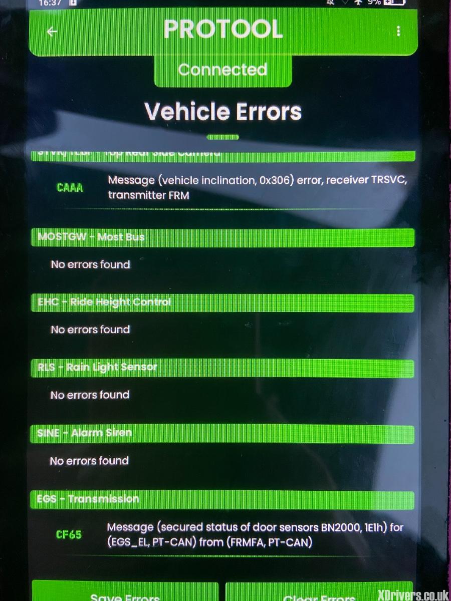

I had a call from the wife earlier saying the indicators suddenly stopped working on the car
When I got I checked, no indicators, rear windows not working, headlights on all the time, no dash lights.
On more investigation, indicators are working, but not showing on dash, rear windows completely dead, and the window lock button is doing nothing, no interior lights, however the reading lights are working and so is the ambient lighting. Elec seats all working, mirrors working and folding, high beam and all other lights working, but nothing on dash! Could this be a fuse? Having looked all seem fine?

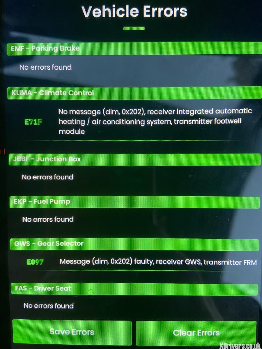

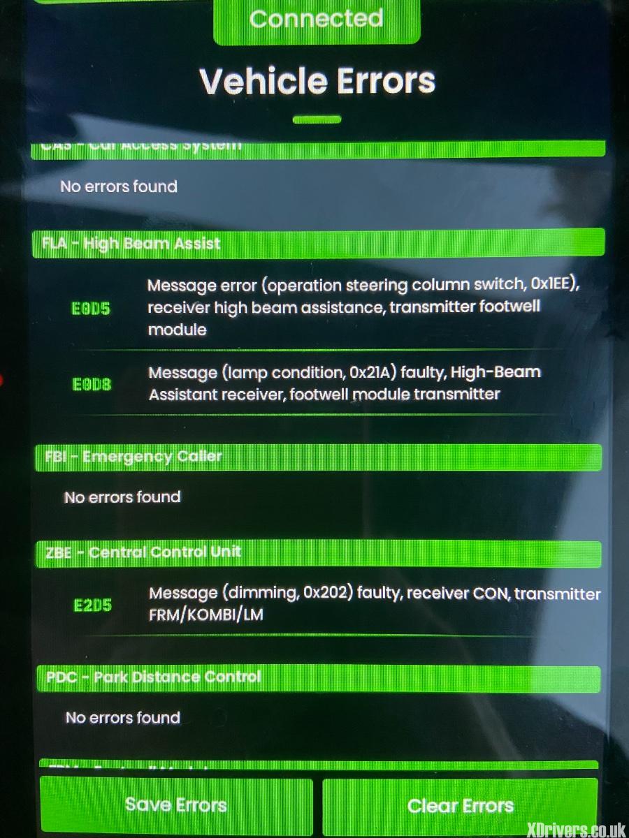

I have scanned the car, errors below using bimmergeeks ProTool.
I thought this might be the FRM, however I can communicate with the frm?
Really need some help
