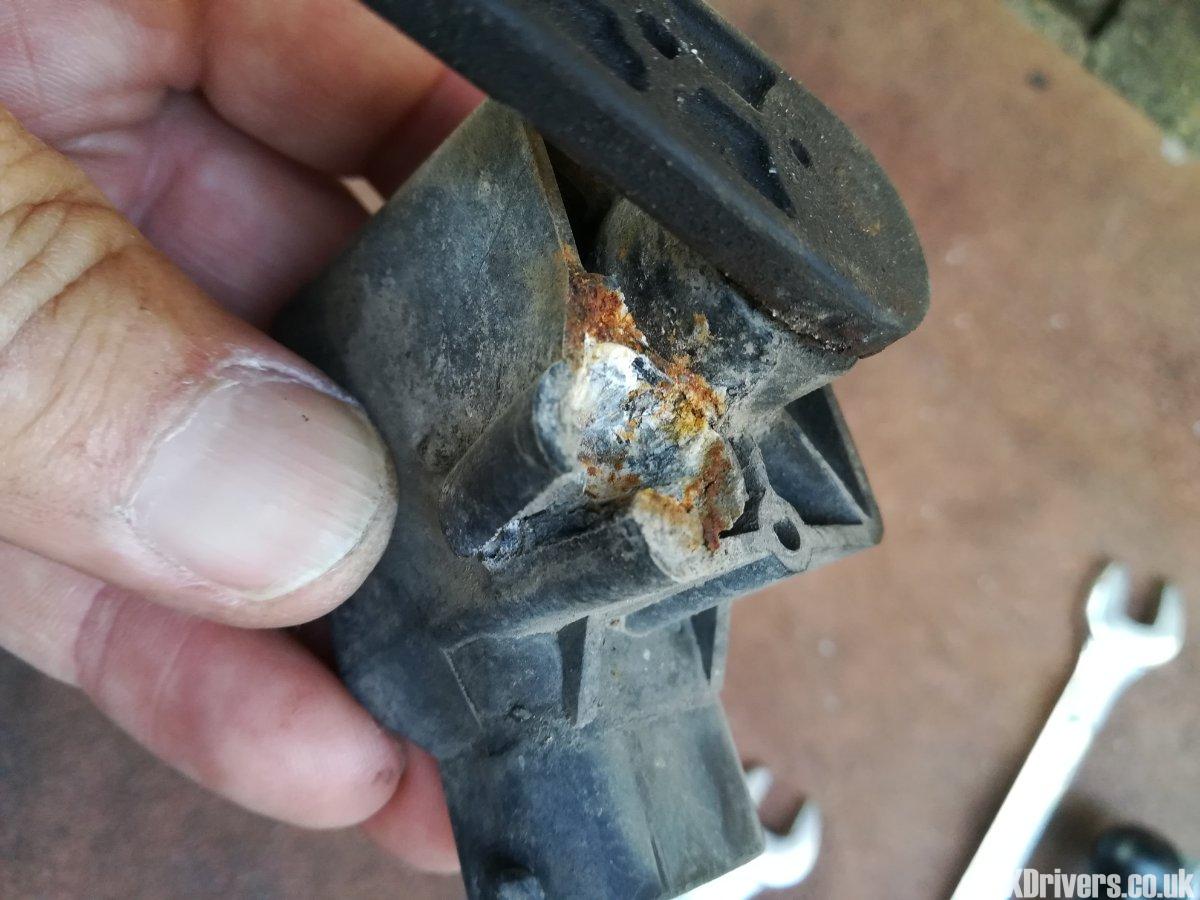

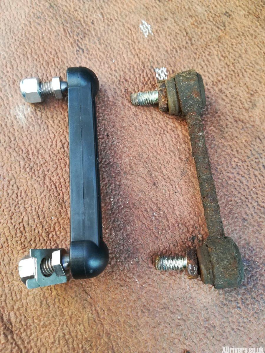

Post by Themoog2 » Fri Sep 18, 2020 1:31 pm
I knew it would be agro.. The little rods came off easily but so did the o/S sensor when the plastic body came away from the bracket...
Posts: 596
Re: Rear suspension problem
Post by Themoog2 » Fri Sep 18, 2020 1:34 pm
The cause was seized ball joints pushing on the sensors old mounting bolts and age. I'm collecting a new bmw sensor tomorrow and I've ordered a cheap one for the n/S as that looked a bit dodgy. It may be good practice to replace the front headlight sensors too..

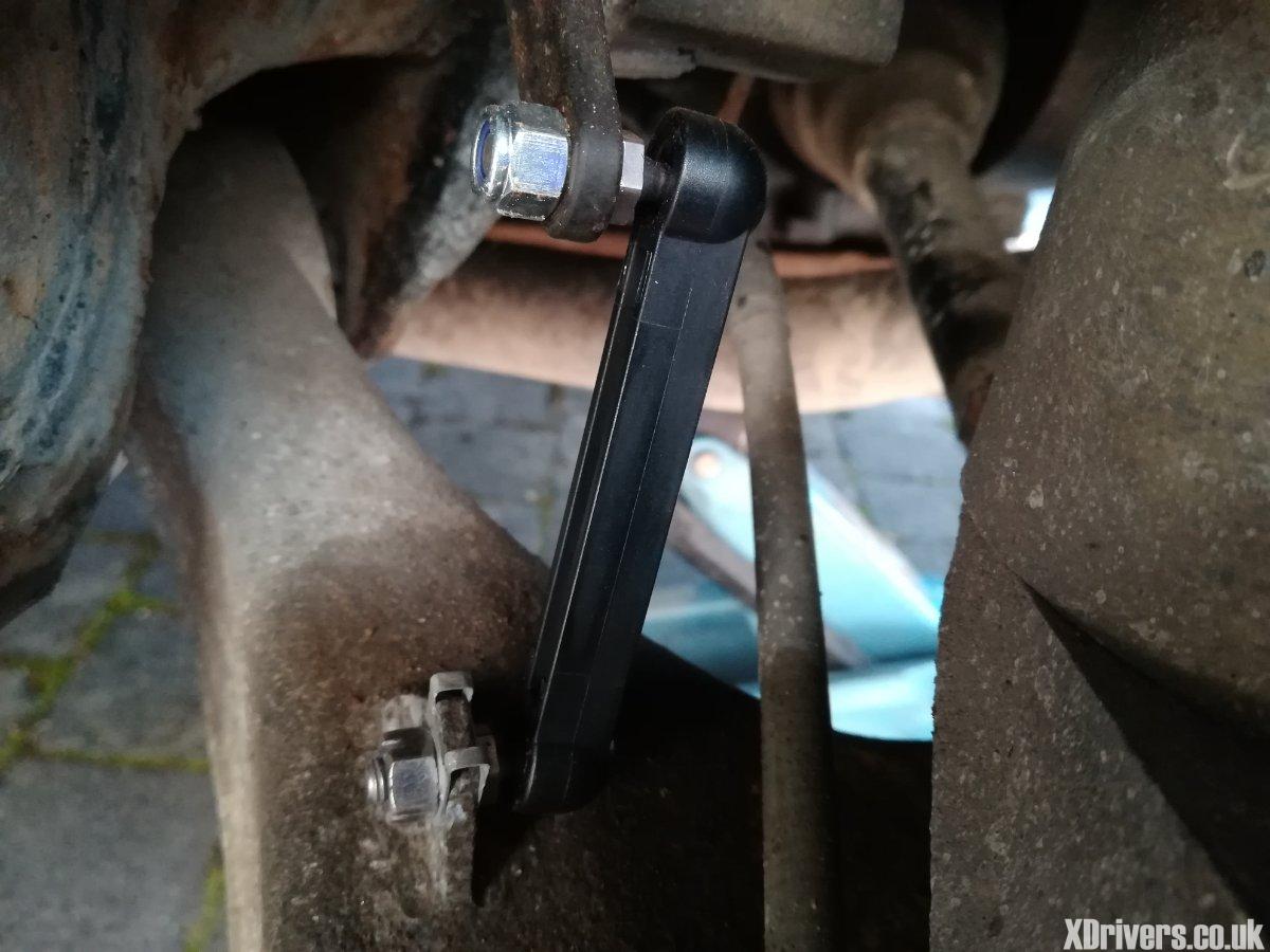

Post by Themoog2 » Sat Sep 19, 2020 1:01 pm
Put it all back together with a new sensor and drove it about for a while.
I left it for an hour and 1/2 and its on its butt again on the o/S where the new sensor is.
It pumps up ok but o/S is still 15 mm lower than n/S.
What do you think? Air bag leak.. Or could the old sensor still on the n/S be the cause..
