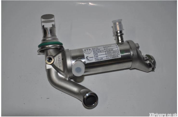

Ive looked under the bonnet of two X5s, one an f15, and neither had it. Does yours have it?
If the 2 pipes coming off it go to the transmission, that makes it a pre heater, if they are coolant pipes, then its an extra EGR cooler.
What this option is I do not know, its not common.
I actually phoned my local BMW dealer, they were no help, told me it was an EGR cooler
Ill have to get under car to remove panels and trace the pipes.

I’ll have a look in daylight. Newtis shows something similar and calls it an EGR Cooler. There must be two types. Do you also have the extra towing weight package - increases from 2.7T to 3.5T? A second radiator in the near side front wing is the giveaway - behind the fog light instead of a fake trim there’s a radiator grille.

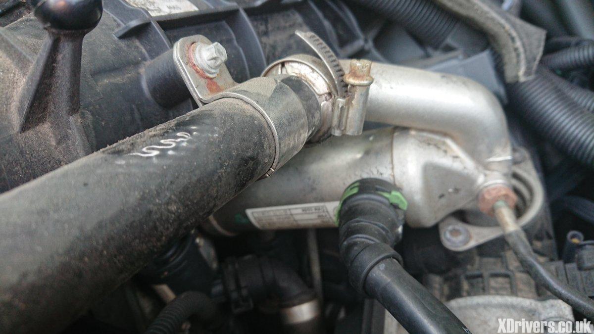

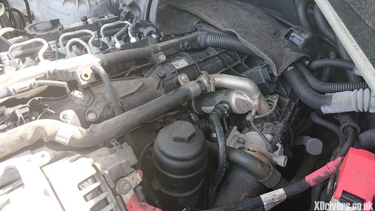

Storm Ellen knocked off power here last night!
Yes I have the small rad behind fog lamp, I assumed that was the extra rad with the towing kit, I didnt realise it was to upgrade the towing weight.
The front liquid cooled EGR cooler with the electric valve sems standard on all, its this rear pre heater/ cooler that not every N57 has, most common is the simple Y shaped pipe.
Im convinced its not a cooler as theres no coolant going to it, only exhaust gases, so a pre heater for the trans is all I can think, maybe a cold climate option or part of the extra weight tow option, no one seems to know

Is the EGR cooling done by air mixing from the cool intake charge air and gas from the exhaust stream. No coolant involved? That being said, newtis says you need to drain the coolant. I haven’t traced the pipes back to see where everything goes though. There looks to be an in/out line for coolant/air?
Just checked mine, and I have the same as you. I do have the towing pack but not the towing capacity increase.
I’m guessing that the parts database is wrong as it looks to be a standard item.

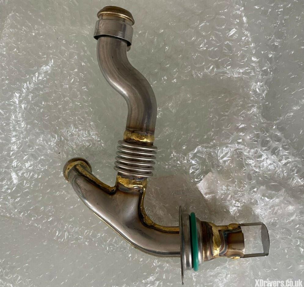

The 2 pipes going in and out of the cooler are for air I think.
Not standard, the standard is the Y pipe with no cooler as in the photo above.
Taking panels off bottom of car after supper.

So a little update, after a bit more research and talking to people, I managed to trace the 2 pipes from the EGR cooler/ pre heater.
The flow from the trans goes go to the pre heater, then to a linked in series water cooled Trans cooler PN 17217800408, then returns out and back to the trans.
The trans cooler also heats the oil, so I can only guess the EGR pre heater is there to make sure it stays up to temp should the engine temp cool down, to keep the trans running at optimum temp and oil viscosity to get best MPG.
I can just simply bypass the pre heater now.
Thanks for help
