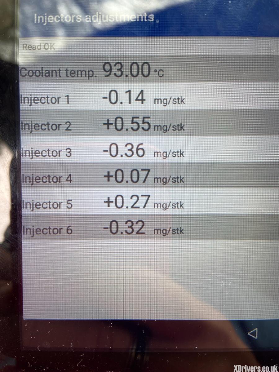

My 2011 30d seems to have developed a more agricultural noise when not on boost, I noticed it the other day after coming off the M23, the engine just sounds louder than usual, and seems slightly hesitant, as soon as it’s on boost it’s fine, I have plugged it to three different diagnostics and on have one error which is 49A6 which I believe is glow plug controller, the dog is regenerating fine though, I have done some live read outs and the MAF is between 3-500mg, don’t know what the values should be or if this would even cause the issue.
I have done an injector read out which I have attached, do these figures seem ok?
The noise isn’t a timing chain kind of noise, and it only does it under load and not idling like I am intermittently dropping a cylinder
Any help appreciated
Cheers

On my old Merc diesel injectors they had to be matched as close as possible.
Looks like maybe you need the injectors checked, and maybe re calbrated. A good diesel injector specialist can do that. Just google for a local one.

It would be interesting to view those readings again after you have run the cleaner through.

The redex seems to be making an improvement, not sure if that’s placebo, but going to get injector reading again either tomorrow or Saturday and see if any difference
