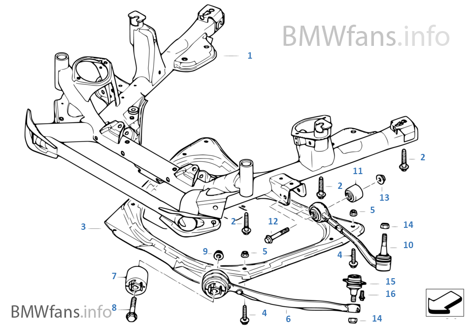

I have the same issue thought it’s not bad, only noticeable high speed and mid to hard hit on brakes (car is 2015 x3 2.0d). I’ve not had the brakes changed as at the last service the dealer said they were fine. Different dealer to where I purchased the car so no cover up of selling me a vehicle with brake issue.

Look at 6 and 14 for play
Posts: 1952
Re: Brakes
Post by henrym3 » Thu Jan 16, 2020 4:33 pm
Sorry 15 not 14

I had the same issue on mine, changed the arm and ball joint on both sides, problem solved.
Cost of parts was £100. It took about 3 hours but worth it.
