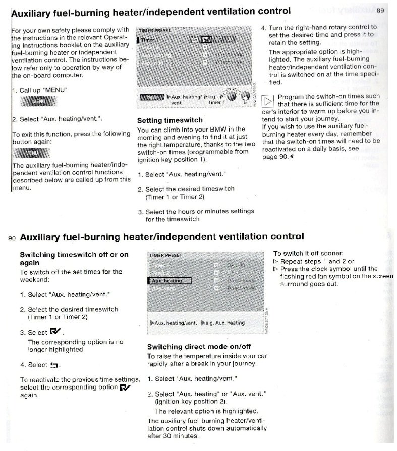

BTW, the red indicator is the Vent timer icon. You have a vent timer programmed in the OBC..
From the manual..
Indicator lamp for the independent ventilation system
Lights up: The independent ventilation system is programmed
Flashes: The independent ventilation system is operating
:thumbsup:

well just goes to show you learn something new, never even heard of the ventilation timer programme. just found the BMW OPERATING INSTRUCTIONS
PAGES 89 & 90 shows how to guide
IV Control 89-90.jpg (175.8 KiB) Viewed 3037 times
for those who haven't got the booklet

shy7g wrote: Wed Aug 21, 2019 10:49 pm
AND... while the manual doesn't state this.. DON'T use the Aux heating if the car is parked in an enclosed space (garage etc.) :fuelfire:
The small Webasto heater (Thermotop-Z) has it's own exhaust pipe etc. and will fill your garage with fumes.

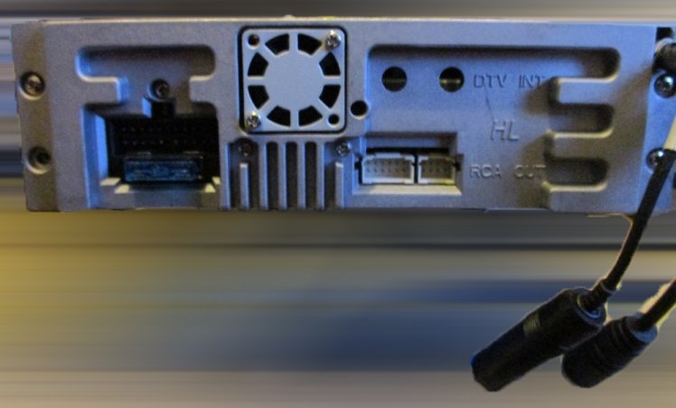

The aftermarket Head Unit
Okay the head unit itself has no manufacturers identity, but is made in that in that most commonly of place's CHINA. The HU is designed specifically to fit the E53 and the way they made it work with the existing BM54 and Alpine Amps was to run the harness cable from the front to the boot space where the wiring harness loops in and out of the BM54 unit and connects back to the existing harness to make the Alpine amp work with the new HU, (well that what it looks like to me anyway :thumbsup: ) along with some data communications know how as well......

Posts: 869
Re: Head Unit sound cuts out after a few seconds of playing
Post by Greydog » Sat Aug 24, 2019 7:55 am
The picture of your after market head unit looks very similar to the Dynavin unit I had in the 4.4. It worked brilliantly until a stuffing great tree got blown over and landed on the car!!
The head unit had Nav, Bluetooth and CD/DVD built in to the head unit TV was a separate DVB receiver in the boot. I added extra cables to the extension loom for radio antenna GPS antenna and DVB antennas which I mounted in the spoiler and the reverse camera so I could use the BMW connections in the boot. Then took out the OEM stuff an sold most of it on Ebay I still have a CD changer somewhere in the garage.
The 4.6 is all OEM but if stuff starts falling over I think I would go the Dynavin route again
