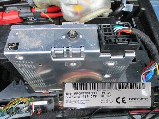

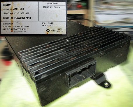

Hi all, at last I've has 5-mins to play on the car, taken the following two units out of the car.
- BMW PROFESSIONAL BM54 AMPLIFIER BECKER 65.12-6 919 078 AND - ALPINE STEREO RADIO AMP AMPLIFIER 65.12-8 379 376

So can someone explain to me what these two units do and which one would more than likely be causing the problem?

The Becker BM54 unit is the radio receiver and first-stage amplifier module and the black Alpine unit is the second-stage DSP amp.
As I've mentioned, the sound will not work unless there is some arrangement to activate the DSP amp (the Alpine unit). If this was working for five years then quit, then something changed that arrangement, whatever it was.
Most likely, there was a software function on the head unit that activated the DSP amp - commonly an app called iBus but there may be other (earlier) apps. My guess you did a software update or changed the software in the head unit and now the DSP activation is working.
But that's just a guess, as I don't have enough information to be sure.

Just read this post an I am confused, the original post says there is an "aftermarket" headunit fitted. Yet there is still a BM54 connected and a DSP unit though the DSP picture shows what looks like water stains on the label which may be the source of the issue.
With my 4.4 when I fitted the Dynavin headunit as Henry has said a long extension lead connected the quadloc connector at the BM54 to the Dynavin head unit basically making most of the stuff in the boot redundant so I took it out and sold it.
So interested in knowing what the head unit is, if it worked with the BM54 and DSP did it work with the CD and Nav or were they built into the head unit?
