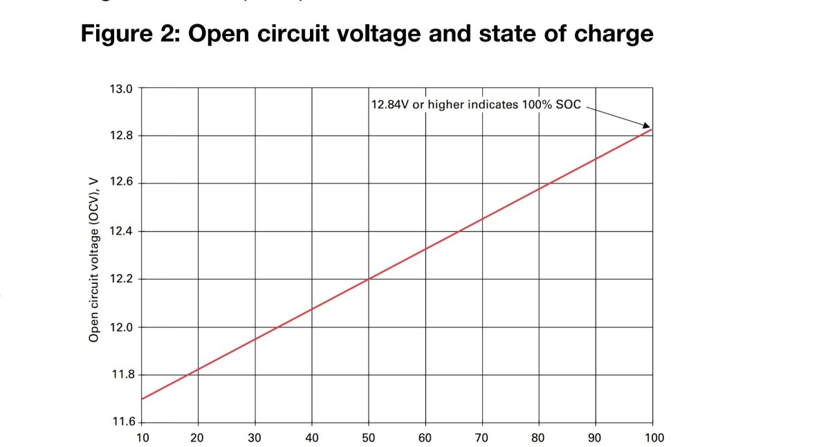

Assuming your multimeter is accurate, then the voltages are low, 12v indicates around 35% of battery charge, should be nearer to 12.8v if fully charged, so could be battery alternator, bad connection a lot of short runs, attac5is a typical battery charge state graph for your I fo.
Sure a much more knowledgeable member will be along with more info shortly
