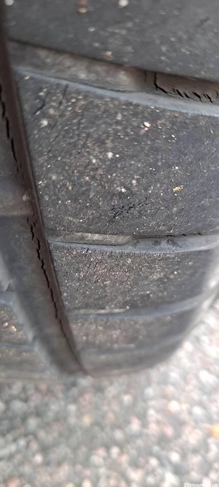

I Just recently had my first MOT at 14800 miles and the Bridgestone Runflats on my X3 20i, not yet 3 years old at the time of the MOT, all have cracks running through the tyre tread and you can see where the rubber is splitting apart. I was very surprised to see that this wasn’t a fail as tyres in my book are a major safety feature and to be honest I’d never ever heard of this type of tyre cracking which is like the formation of a crevice within the tread on one of the tyres. The tyres are Bridgestones 245/59 R19, but apparently it’s not a failure only an advisory. When I approached the dealer, they essentially said they’d been down this track with BMW with other customers and they won’t help in getting a resolution. And in a nutshell I raised a complaint with Bridgestone and in there reply they’ve already prejudged the outcome of a claim against them. This was after I sent them some photos and they gave a whole host of reasons for why the tyres in my care have gone like this, although they will take a look at the tyres, once I’ve bought and changed the 4 tyres out for a manufacturing defect. Needless to say the obstacles thrown up make me feel it’s not worth proceeding but for a tyre that still has 6mm on the rear and 6mm centre and 4mm on the outer fronts, and not 3 years old, I’m obviously very disappointed and they have effectively lost a customer, as I’ll now look at replacing them with the Pirelli Centurato P7, which hopefully will also improve the ride? What’s evident is that tyre manufacturers guarantees aren’t worth the paper they’re written on…

Those are well past their best zippy but at 15k I'd say you have done OK with them. Wasting your time contacting the tyre manufacturer after all this time I think.
Outer shoulder wear certainly a problem on x5 front tyres especially if you don't have runflats and use standard pressures they just look flat... Which they are, ordinary tyres need more pressure as the sidewalls are far weaker.

Cracking might be due to too much heat being generated with the tyre flexing due to under inflation as well .

To see so much cracking fairly widespread across the whole tyre is surprising....I'm also surprised to see so much tread available after 14800 miles I get nothing like that out of the Alenzas I had (2 sets x4) I'm now on Pirelli Cinturatos (19") so we'll see how they go. Just checking we are talking X3 G01 here aren't we?

Yes Stinky it’s definitely a G01and Leslie, in my ownership the tyres have always been at the right pressures. I’ve had it since December ‘18. The car was originally registered end of March ‘18, but wasn’t actually put on the road until end of August, so I have no knowledge of its storage and on road condition during the first ‘official’ part of its life.
Here’s the relevant body of the letter I received back from Bridgestone, as you will see there are many reasons given for why the tyres could develop these cracks and whilst not directly saying so ‘lack of use i.e. lock down is an obvious contributory candidate.
‘ Based on the images you have provided the concern seems to be surface rubber cracking in the main grooves. The cracking on the tyre is due to oxidation of the rubber, which causes the rubber to become more brittle, and crack under stress. Ageing of the rubber is accelerated by exposure to certain factors, such as sunlight, sea air, contaminants (including tyre blacking agents), and ozone (which can come from motor exhaust and electrical motors). The effects of ageing are particularly noted when the vehicle is parked up for periods of time, and the anti-ageing oils and agents on the surface of the tyre are broken down or washed off, and not replenished from within the tyre by the tyre’s movement. Also, oxidation of the tyre is possible when the rubber is under stress, the more stress the tyre is under, the more likely the tyre will suffer from oxidation. Tyres which are run with insufficient pressure are more likely to crack in this manner.
Tyre manufacturers add ingredients to rubber compounds to slow down the rate at which tyres age. However, conditions of storage and use (including tyre maintenance) have a larger influence over the tyre aging process. Tyres that are used infrequently (low mileage) and/or in coastal areas will age more quickly. Low usage prevents the anti-ageing oils from migrating to the tread surface (oil replenishment at the tread surface is diminished), so causing the tyres to display surface rubber cracking.
From the images you have provided, I can confirm that in their current state we would recommend that you continue using the tyres, as the surface rubber cracking is not compromising tyre safety or the tyres dynamic characteristics. Apart from the visual appearance of surface cracking the tyres are totally fine for continued use. However, you should check tyres regularly for any signs of damage or further deterioration. A change in the dynamic properties of the tyre and/or vibrations could be an indicator of the effects of tyre ageing. If any such symptoms appear, replace the tyres immediately.’
