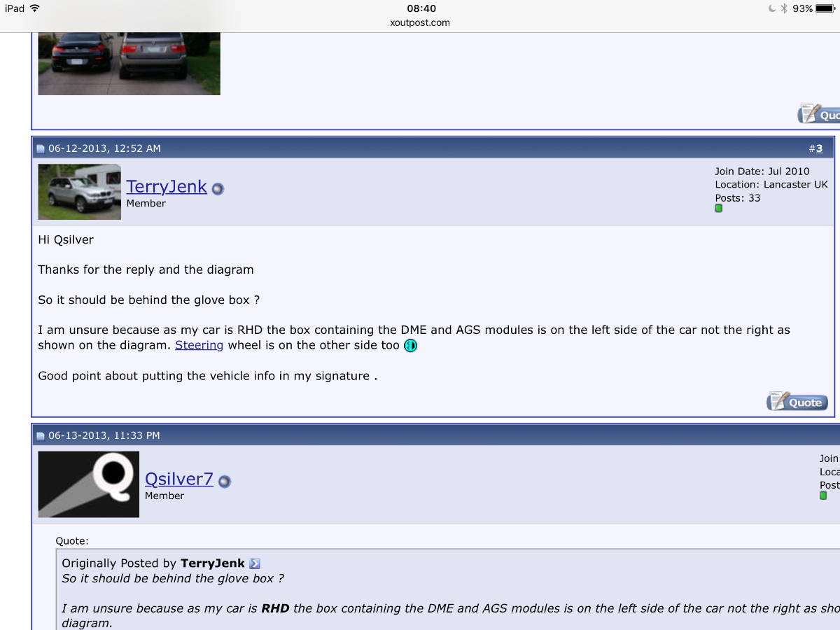

In post #3 in the outpost link it says on the RHD ars the module is on the left side, not the drivers side.
