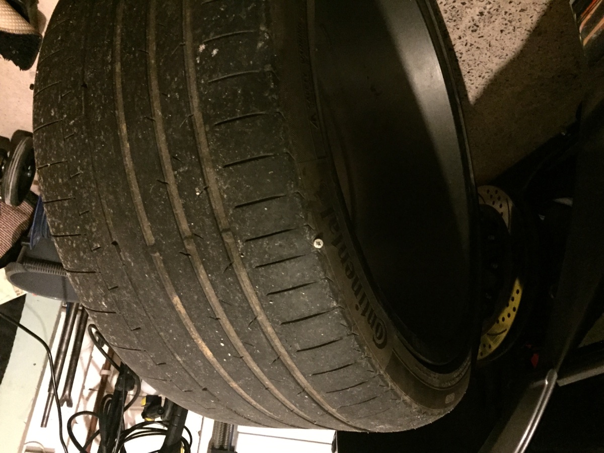

Post by henrym3 » Mon Jan 14, 2019 7:55 pm
Don’t you just hate this sort of thing.

Post by henrym3 » Tue Jan 15, 2019 12:04 pm
Interestingly the tyres have got Tyre Safe in them and it still went down, as an experiment I layed the tyre at an angle for a few hours before taking the screw out but the hole didn’t seal and nothing except air came out. Because of the size and having to wait for tyres to arrive I have experimented with one of those puncture repair kits where you ream out the hole and then push the thick sticky thread like stuff through the hole, been in there two days without any loss of air. Very impressed and certainly something I will carry on the vehicle as a get you home piece of kit. For £10 well worth carrying. Obviously you need a compressor to blow the tyre up.

Post by Leslie » Tue Jan 15, 2019 2:10 pm
A puncture repair at the edge is a bad idea with all the flexing of the sidewall it will fail sooner later.

Post by henrym3 » Tue Jan 15, 2019 3:18 pm
I agree Leslie, it’s just a temporary measure until tyres arrive.

Post by Leslie » Tue Jan 15, 2019 5:22 pm
That's good just saying as many years ago I had a tyre with a screw right on the edge of tread repaired as it was a near new Pirelli and about 1000 mile later the patch came of causing rapid deflation ,tyre came of the bead on a roundabout cornering hard and I was very lucky not to crash.
