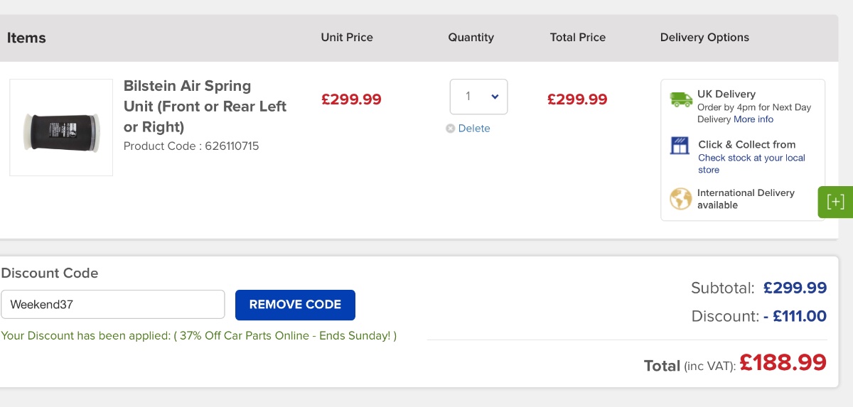

Just reserved bilstien one from eurocarparts
37% off so £189

Arnott is about £160 or bilstein I can pickup tomorrow £190
Arnott or bilstein?

Post by celica » Mon Feb 11, 2019 9:31 am
I’ve gone for bilstein and hoping to get it fitted tomorrow and fix the problem
