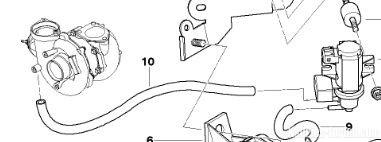

Am i right in saying that there is only one vacuum hose to the turbo. I found a thin hose running from the pressure converter over the intercooler pipe and down into the turbo area but cannot see where it goes to. It appears to be connected as it doesn't come away when pulled on. Its hose 10 in this pic

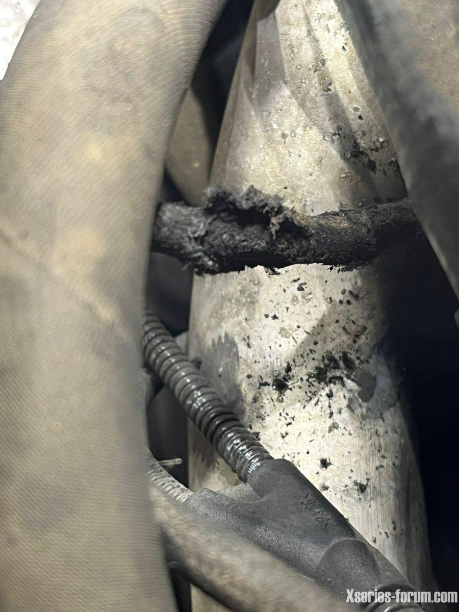

What i did find however is that the pipe was badly frayed where it passes over the intercooler pipe but i didn't see any splits in it. If this is the damaged pipe how to i connect it to the turbo when i can't even see where it goes.

- frayed hose.jpg (148.26 KiB) Viewed 52423 times
2.0d manual lack of power low rpm
There should be a vacuum valve on the turbo with a rod to the actuator, the vacline just pushes onto that valve., that line needs changed as you are not operating the variable vanes so have no low down boost.
Thanks Leslie. What is the best way to get to this. Do I need to strip out the intercooler pipe etc as I can’t even see the actuator let alone get my hand in anywhere. Thanks.
Can you have a look from underneath up on ramps ? ,it may provide better access, not familiar with your model so cant advise .
