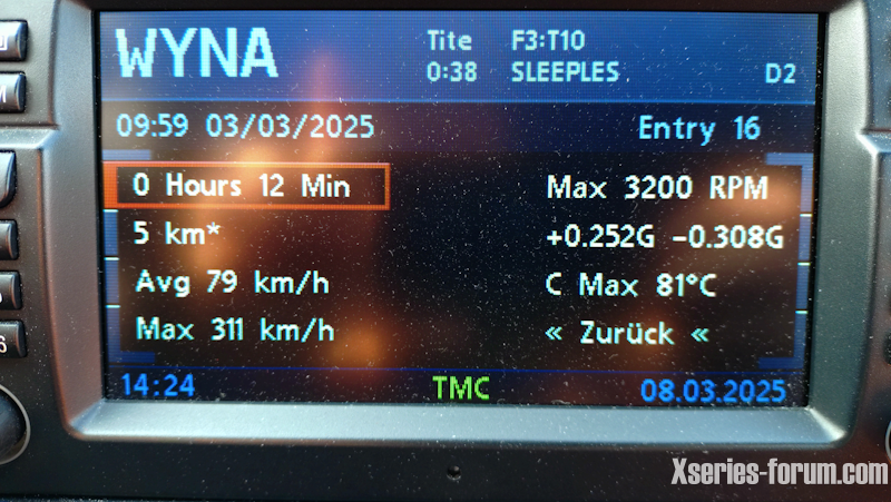

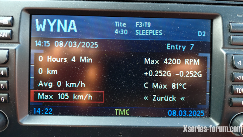

Journal of Log Trip
Journal of Log Trip
The Journal of the Log "Trip" (real Speed was like ~20 to 25 km/h
And the max I found in the Journals (the E46 is quite a nice and still somewwhat fast car even by todays standards, but more than 300 km/h at 3200 revs/min is a bit too optimistic ;)
Fastest E46 on the planet

OK, so these are the speed and RPM numbers I see in that log, do they look about right?
IBUS: 00:03:20.13 80 05 BF 18 00 09 2B [2B] -> 0 kph, 900 rpm
IBUS: 00:03:22.13 80 05 BF 18 00 0A 28 [28] -> 0 kph, 1000 rpm
IBUS: 00:03:23.45 80 05 BF 18 02 0C 2C [2C] -> 4 kph, 1200 rpm
IBUS: 00:03:25.44 80 05 BF 18 07 18 3D [3D] -> 14 kph, 2400 rpm
IBUS: 00:03:27.44 80 05 BF 18 10 2A 18 [18] -> 32 kph, 4200 rpm
IBUS: 00:03:29.44 80 05 BF 18 07 0A 2F [2F] -> 14 kph, 1000 rpm
IBUS: 00:03:31.44 80 05 BF 18 00 09 2B [2B] -> 0 kph, 900 rpm
If they are, that means something odd is happening when displaying or saving/retrieving the numbers from the Journal entry. As these look reasonable and do not match the Max and Avg numbers you're Journal shows it is reasonable to assume that it's not the speed being read from the iBus message that's the issue here.
There are a couple of possibilities, but I suspect that the most likely is the 'Speed Correction' value. It's possible that this has managed to get set to a silly value when updating the firmware from an old version that does not support it, to the latest.
Go to the 'Extras' menu option, then 'Extras Settings' and see what 'Speed Correction' is set to. It's specified as a percentage, if you go to change the value, it won't let you enter more than +/- 25%. but until you change it the current value should be shown.

Post by DoubleM » Sat Mar 08, 2025 9:28 pm
Yes, the values seem reasonable. 32kph maybe a tiny bit high, but within the margin. (much better than the shown 105 kph)
