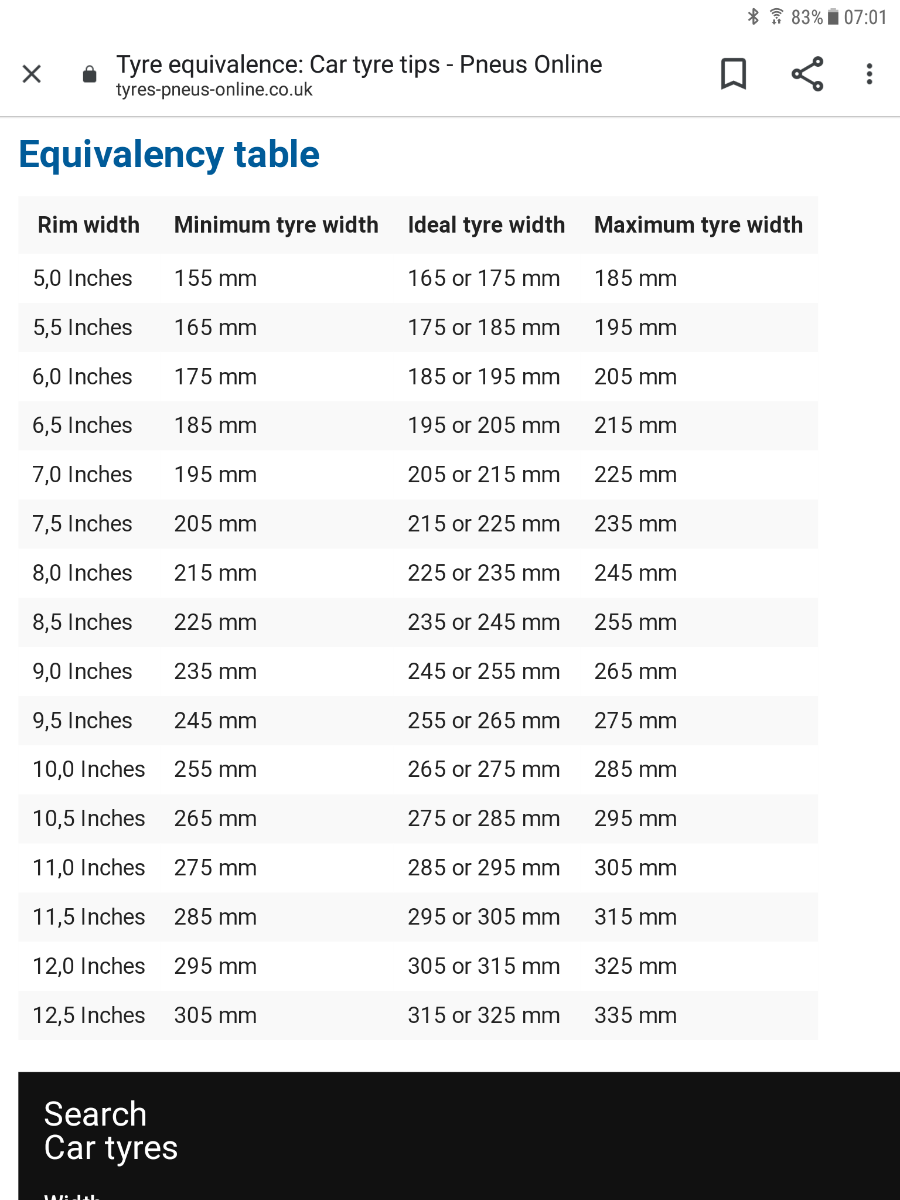

Re: Winter Tyre Info and Discussion Thread ( Keep related chat here please)
Post by StuBeeDoo » Thu Sep 05, 2019 9:27 pm
RossC wrote: Thu Sep 05, 2019 9:15 pm
sapphireblack wrote: Wed Sep 04, 2019 11:18 pm...Or, simply go 285 40 20 all round on staggered 20s.
This seems to be the option that’s most likely now, as I’d like to avoid (especially large) wheel spacers if possible. Do you think 285’s would be happy on the staggered 11inch rear if 315 is the norm?
If this was to work, having a square setup would mean no worrying about * rated tyres, but I’d probably stick to runflats... Limited options though, Continental Winter Contact only by the looks of it.
285s should be fine on 11in rims. Click here & scroll down.
Posts: 2017
Post by sapphireblack » Thu Sep 05, 2019 9:30 pm
These are permitted tyre /wheel combos. I've noted before that according to general published data, a 315 tyre on an 11" rim is actually too big and that 285 is better suited
285 section tyres on 10" rims is maximum, on an 11" rim its minimum, apparently.
** Whoops a bit slow. Looking again, you (we all) could use 275 40s all round :wink:
