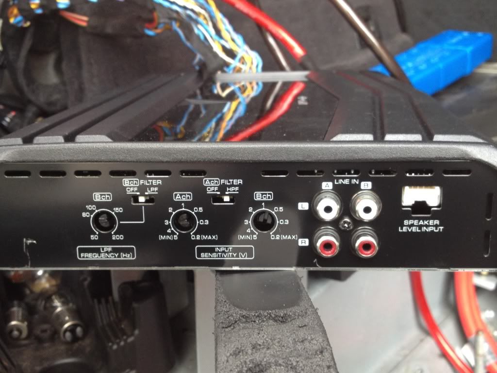

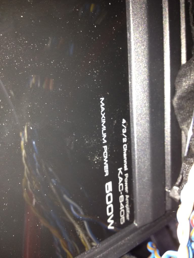

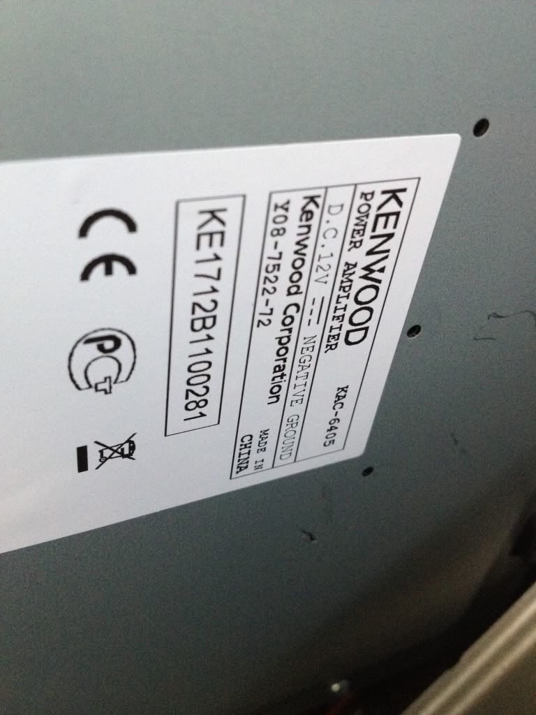

Hi sanj, sorry its been awhile since posting, john came and had a look at it, said it was something to do with the levels on the amp being to high, adjusted them and left, well the whine came back as soon as he left and he as yet has not returned my calls.
hubby managed to get the amp out for me to take some pics for you, hope they help.
thanks
janette

The input sensitivity is used to match the output of the headunit and all that would do is try and mask the whine. What you would need to do is connect your ground loop isolator to the RCAs going into the amp (although I'm not 100% convinced it's at this end that the issue lies). Looking at the pics I still think it could be on the mass of output speaker wires combined with the remote wire or something.
Definitely try the isolator first though.

- Sanj
- Lifer
- Posts: 5624
- Joined: Sat Jul 31, 2010 11:45 am
- Location: Berkshire
Re: I hate DSP
Still here, sorry I missed the post with the new forum layout.
All other suggestions should be noted!

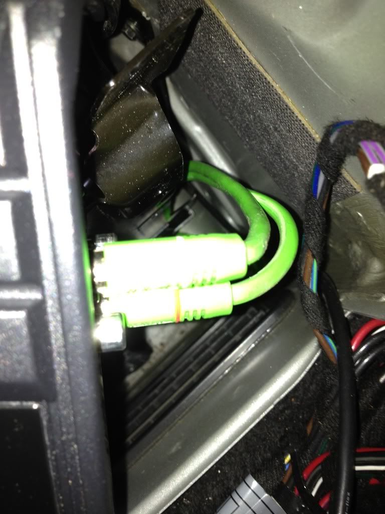

Can you tell me what the green phono cables connect to?
COME ON ENGLAND!!!!!!!!!!!
(in years to come this was the Euro 2012 game at the time)

Hi, there are 4 green cables and they all go into the where the white and red line in sockets, when you unplug them the speakers don't work.

Get the ground loop isolators mentioned and connect them inline. You need two (front and rear), get them from some where that will take them back too.
Should sort it out. Reckon £10 to £12 max.
