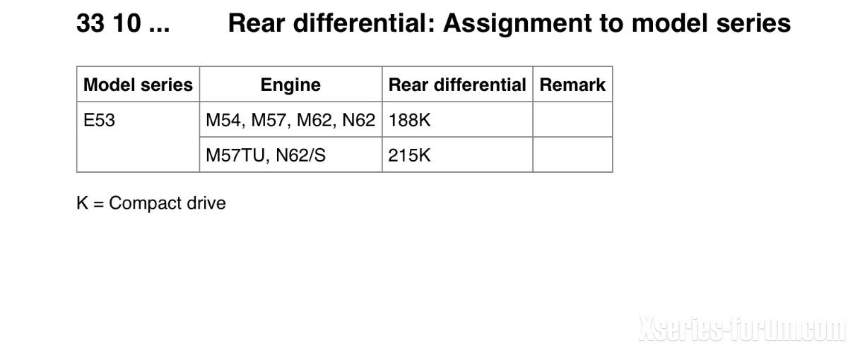

You could get a rear diff from a salvage yard. There should be a stamping on the casing with a number in it. The number is important as it confirms the ratios within.
Interested to know what tyres/tread depth in case that was a reason for the diff breaking in the first place. It’s certainly one of the causes.
