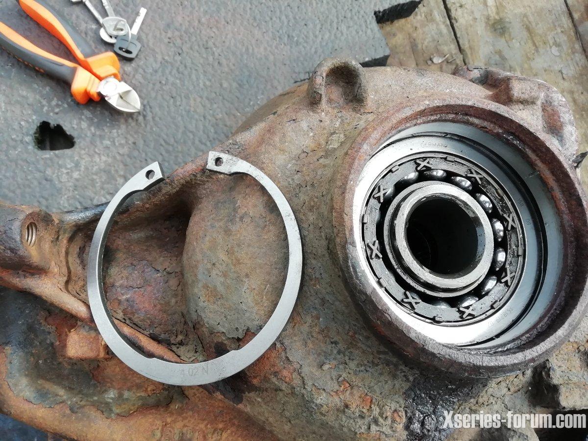

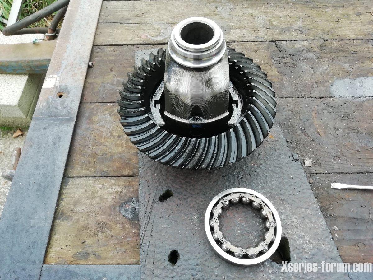

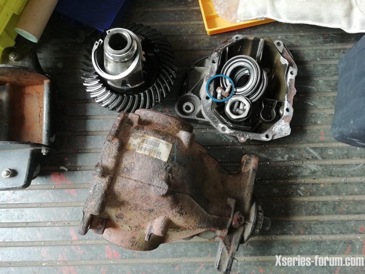

Got the x5 back yesterday with the secondhand diff now fitted , did 150 mile towing :driving: today and all seems ok so far . I stripped the old one down today , needs a big pair of circlip pliers to squeeze those spacers to get them out ,I only had a medium sized pair and they struggled , side bearings come out easily after you sand round the ring of built up rust then crown wheel lifts out . Side bearings look perfect to me and would go again, each side has different sized shim so need to be back where they came off.

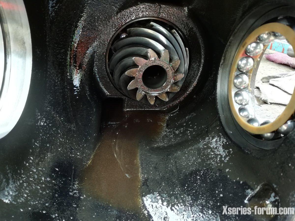

Withe the crown wheel out you can't turn the pinion by hand bearings must be in a bad way and bottom of case is full of metal swarf , the bearing I can see on pinion looks ok must be inner one is toast. Thought you might like to see some pics :D Will take the pinion out at a later date when I managed to get it held to undo nut.

Nah……where’s the ‘Ammer’ an screwdriver? Good set of cutters though :D
At least the crown and pinion are intact. As you suggest, bearing failure likely issue.

It would rebuild I think best kept in case the other has short life , can never find those damn cutters when I need them lol must have had them out for something else as no use here , put a face shield on as those circlips could spring out and leave a mark and I've already been mashed by a tin of grease that fell abiut 10 foot out of the loft in the garage when I moved the wooden ladder the day before now that smarted a bit, hit me on the temple with the lip of the bottom of the tin ...ouch ! :rofl:
I don't think anybody will sell me just the pinion bearings so id have to buy a full set at near 300 quid but as I found out the 3.64 diff is in short supply and command high prices :headbang:
