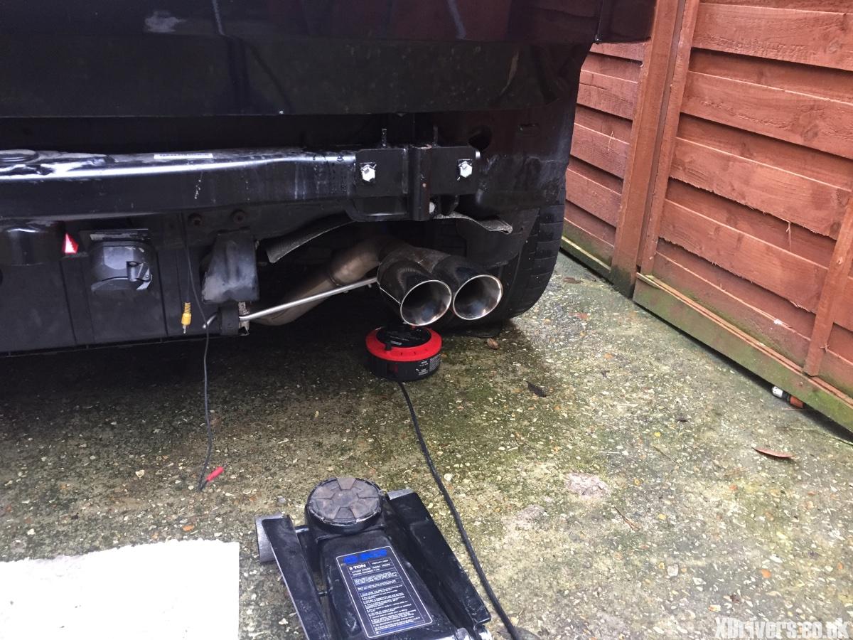

Update on the battery.
So far the one in the car is ok. The one that went flat and I removed, charged on recon with the ctek measured 12.8v this morning so in theory it’s in better shape than the one in the car...
Posts: 19210
Re: Battery.Again..
Post by X5Sport » Fri Jan 15, 2021 8:29 pm
See how it is after 24 hours. If it’s still showing 12.8V that’s a good battery indeed. Brand new it would show that figure and decay steadily over the battery’s service life.
Posts: 600
Re: Battery.Again..
Post by Themoog2 » Sat Jan 16, 2021 4:12 pm
It’s already been over a week and it’s still 12.8v so that’s ok in my book. The only thing that I can think of that flattened it was a combination of short trips and the dash cam falling off and setting the alarm off.
