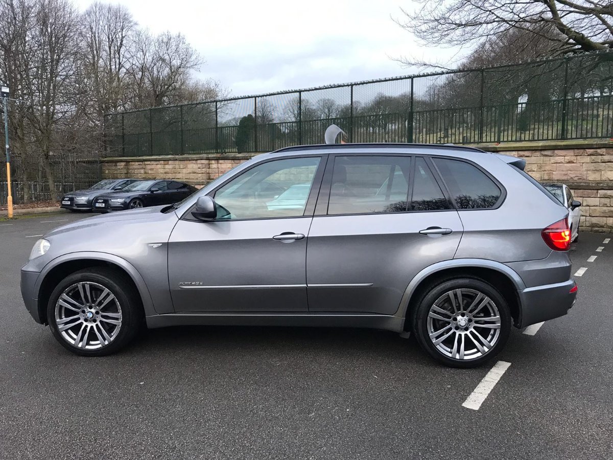

This was before I drove it up the road, its filthy now. The car drove fine with no real issues apart from the front ns tyre is really badly tracked on the outer edge. Looking at the rest of the tread it doesnt appear very old. That and the edges of the rims are kerbed badly.
I did notice when flooring it briefly there was a bit of black smoke indicating unburnt fuel. Is this normal on these or should I investigate further?
According to the idrive it returned 36mpg on the motorway journey home.
