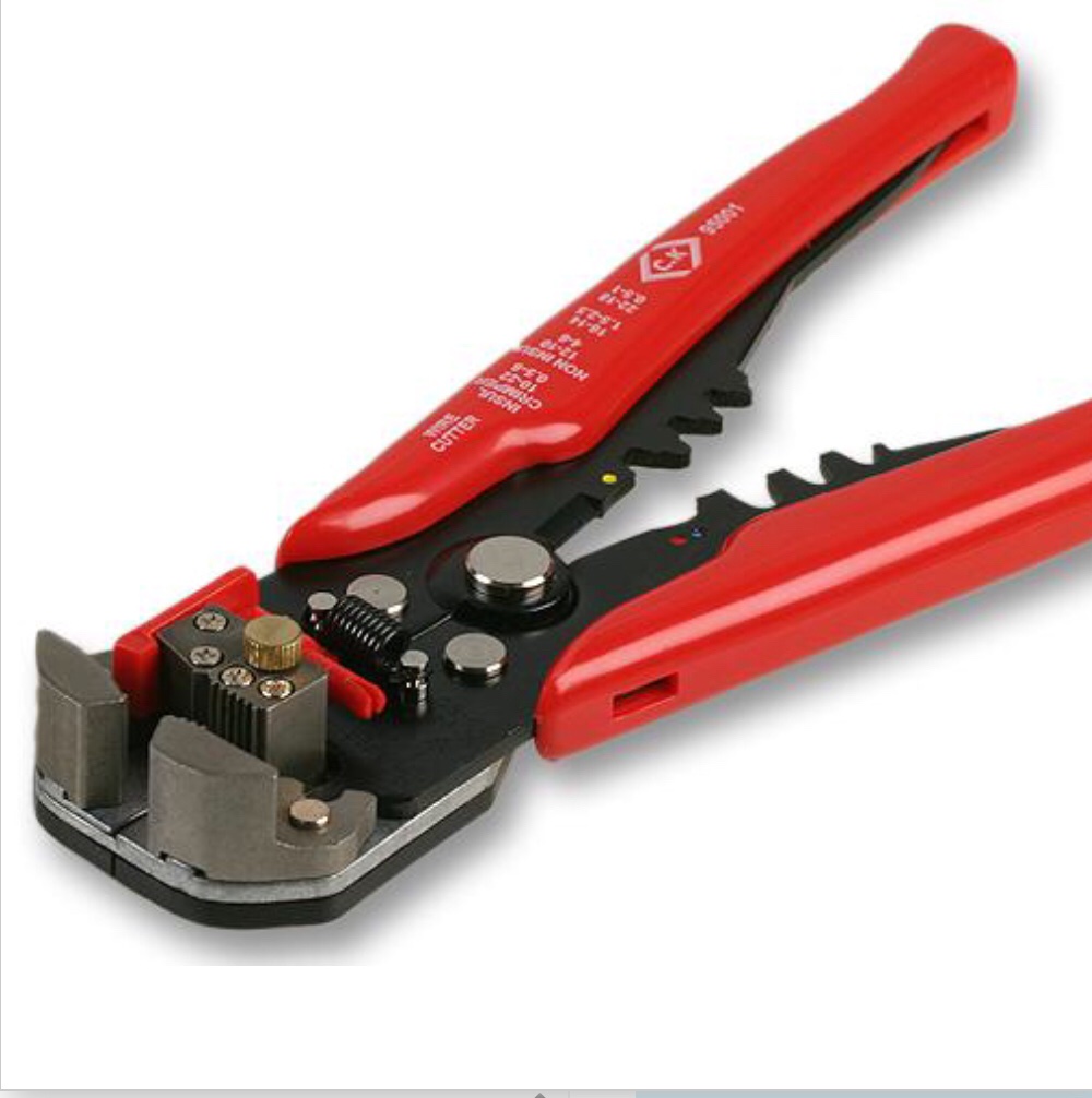

All wiring was done in the boot area using wire splicing tool and heat shrink with soldered joints
I don’t like the block connectors
