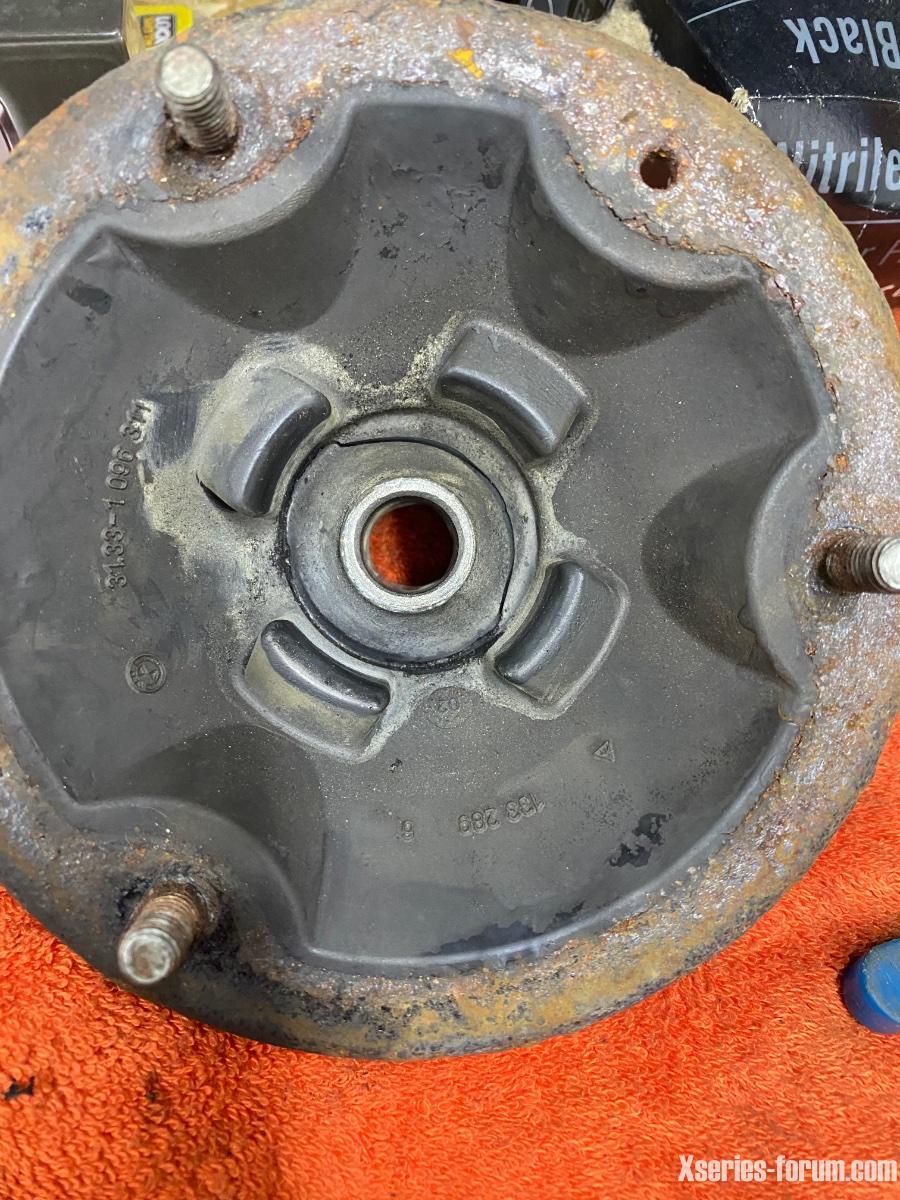

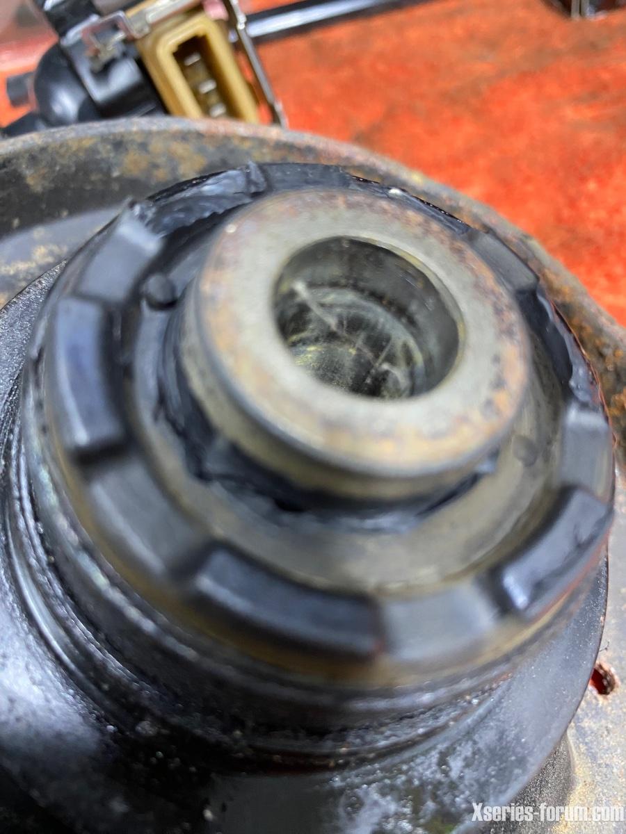

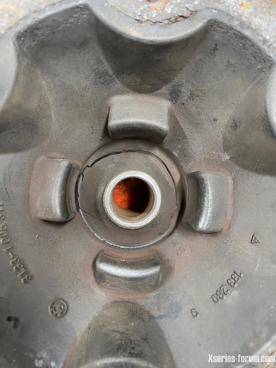

Next day jumped into the x5 and set out again, all went well until the way back, I had done about 400 miles at this point. Suddenly the dash lit up with all the usual suspects but no drop in performance but the steering wheel is off to the left?? Anyway, quick diagnostics tell me the fault is the steering angle sensor. Start up again and all faults gone but steering is still off center. At home I can’t find anything wrong with the suspension or steering nothing loose. Next day I decide to take the front strut out to find the top mount the bit with the 3 nuts that secure the strut to the tower the rubber center piece is completely shot. So I’m assuming that is the problem ATM I’ve put it back together and I await 2 new MEYLE top mount’s arriving this week. BTW I did just short of 600 miles and did 21 mpg also managed to do it all less 47 miles on lpg. Oh 1 other fault the intermittent wipers stopped working. I believe that is a relay problem but that particular relay is over £80. Such a shame you can’t wander around scrap yards anymore.

The MEYLE top mounts have arrived and I will hopefully get them fitted this week. The intermittent wipers are fixed by removing the relay and taking the cover off and using a mixture of sand paper and the wife’s nail file to clean up the contacts. I like these cheap fixes.

They must have been ready to give up for some time and just needed that last pothole to finish them off. To be fair I have had a rattle/knock for some time and put it down to the drop link
The wheel is much more central now but needs an alignment and the knocking at fairly low speed 15/20mph is gone so I’m putting this down to a fairly cheap success.
