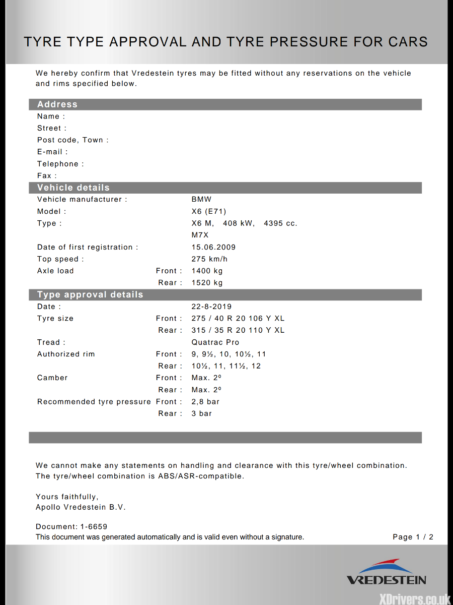

As an aside i still have an unused wheel set with Pirelli * winters on them but thoughts have turned again to all weather options, albeit none afaik are runflat. I emailed Vredestein a while ago who confirmed they are happy with their staggered size Quatrac on BMWs fragile transmission. Of course if the tranny had a hissy-fit i doubt they would pick up the bill.

That’s incredibly useful given I need a set. If they’re prepared to put their stamp of approval then brilliant. :D
Just can’t get them in the 19” rear size 285/45/R19 (so far at least). Fronts 255/50/R19 are fine but not the rears it seems :(

Post by Leslie » Thu Oct 01, 2020 8:15 pm
I'm interested in those tyre pressures 2.8 bar front and 3 bar rear , a lot more than quoted for runflats ! :D

Post by sapphireblack » Fri Oct 02, 2020 6:45 am
Leslie wrote: Thu Oct 01, 2020 8:15 pm I'm interested in those tyre pressures 2.8 bar front and 3 bar rear , a lot more than quoted for runflats ! :D
If i had posted page two it would be useful :roll:

Post by rockwell » Fri Oct 02, 2020 11:06 am
I obtained the exact same disclaimer from Vredestein when I enquired about fitting All Season Quatrac Pro 235/55/17 all round on my elderly e83 X3 3.0d manual.
I also received a veiled non committal nod of approval from a BMW main dealer. So far the Quatrac Pro's are a huge improvement on the Pirelli Scorpion STR (M & S)
