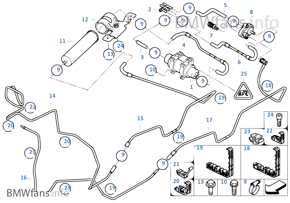

Looking at this pic it only shows one filter.
You could check the suction jet pump hasn’t failed by checking the hidden menu to see how much fuel is in the left and right tank or just bung a five litre can of diesel in the tank and see if it starts and runs ok.You do not have the required permissions to view the files attached to this post.
