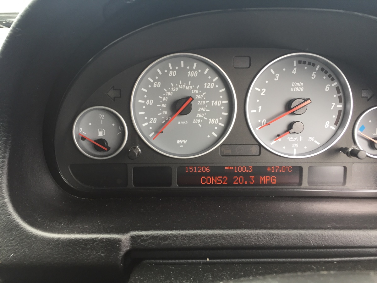

Post by henrym3 » Sat Jun 15, 2019 4:02 pm
Just been over to lreland, took this pic cos l’ve never seen mine above 18.

Where did you get to go that far down hill in Ireland Henry?? That is an impressive average just shows what you can get from a well maintained V8 with all the wheels pointing in the same direction. What tyres are you running?
