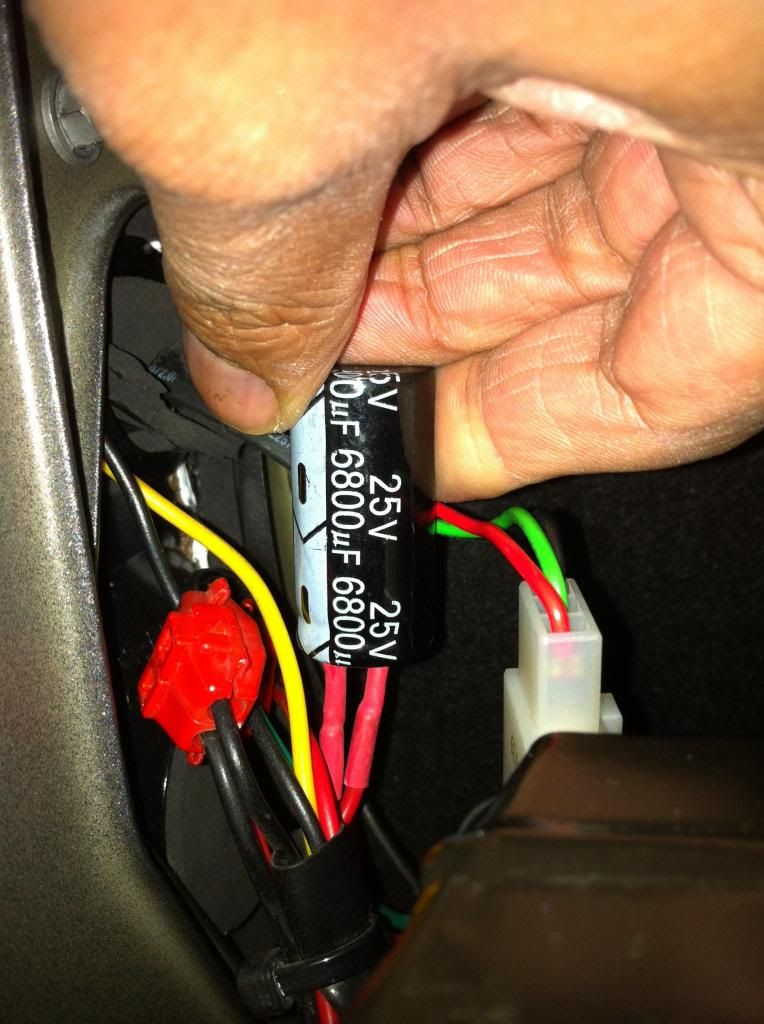

Sanj
Posts: 5624
Location: Berkshire
Re: LED Tail Lights installed but have some issues
Post by Sanj » Fri Dec 14, 2012 10:40 pm
Really sorry buddy, pi$$ed down all day here.
Apparently dry tomorrow and Sunday, so I'll get a pic for sure over the weekend for you.
Sanj
Posts: 5624
Location: Berkshire
Post by Sanj » Sun Dec 16, 2012 5:16 pm
Pic as requested...
Posts: 19167
Post by X5Sport » Sun Dec 16, 2012 5:27 pm
[quote="PhilUK"]
Hi X5Sport.
The ones I have just ordered from the ebay link above state that they are 50w/6ohm, are these going to work?
[/quote]
I would think so.  50W is pretty adequate for that sort of use.
@Sanj, that's a pic of a capacitor.....not a resistor.  Good suppressor though.
