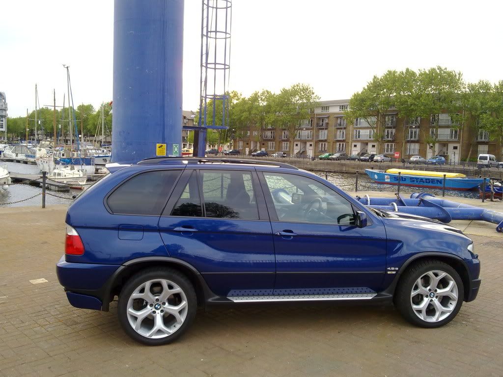

Would love to see some pics if u have any Raj?

Post by Raj » Sun Jan 22, 2012 10:20 pm
[quote=""j2d""]
Would love to see some pics if u have any Raj?[/quote]
Hi John,
only pic so far is this one:
Put them on then it went straight into Bal for ICE install.
