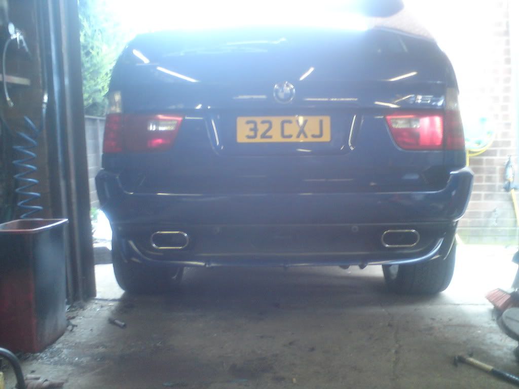

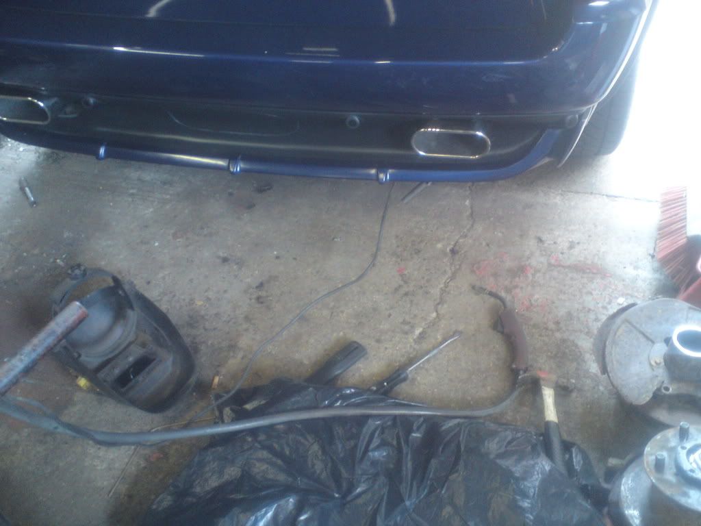

just finished doing my exhaust conversion on my 3.0d bout an hour ago, i spent £60 on stainless exhaust tips and 6 hour with a grinder and welder......

Looks mint shadrak, where did you get those tailpipes m8? :)
Lee4.8is
Posts: 902
Joined: Wed Nov 03, 2010 5:59 pm
Location: Lincs
Re: X5 Exhausts
Post by Lee4.8is » Sun Sep 11, 2011 7:16 pm
Lovely result,bet your dead chuffed.
They look like a professional job & sit really well.
Enjoy your new look.
Lee

well chuffed with them, i got the stainless ends from local place that makes custom exhausts £60 the pair, had to cut them about all over to fit and it took some measureing to get right, i spent 3 hours last night and a few hours this morning doing it, who else was welding away at 9pm last night! the tips are also only 5mm one way and 3mm the other from oem size 4.8is ones so look mint. imo! :driving:

Top job there fella looks the biz

Do I take it these are just for show but mounted on the oe boxes? They look really great. Nice one mate :-)
