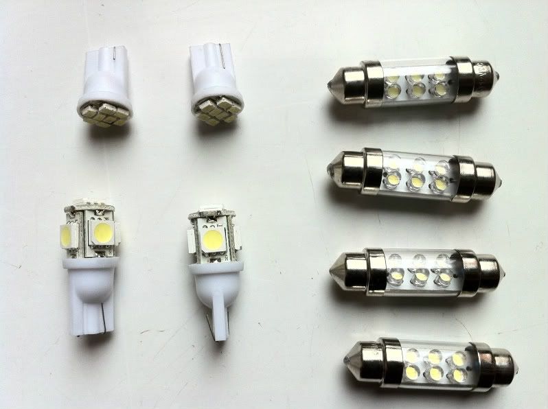

I have uploaded what came through the post today.
4 barrel bulbs for the doors
2 bootlid ones
2 overhead ones - you'll need to make the hole in the reflective plastic a bit bigger, easy to do once you get it out
Is it just me or are there no pics to see? <!-- s:| -->:|<!-- s:| -->
2 bootlid ones

Sorry forgot to upload in the last post . Here you go sanj
bmw x5 le mans blue
