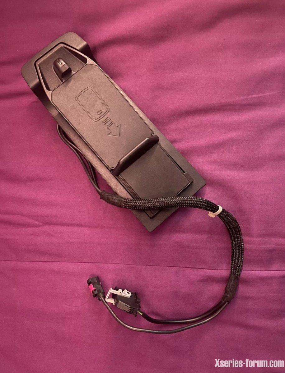

So, I've taken a punt and ordered this wireless gizmo.
Fitting is detailed in the YT link above but when the weather will permit me to do it dont know, it could become a long term project 🤔

Finally the weather improvement inspired me to venture outdoors to car tinker. I can't beleive I've to had to wait so long to fit the wireless phone charger i bought last year. No wip pictures im afraid, i was too absorbed with the task so there is only one end result image. The blue LED '"charging on" is illuminated but a phone camera doesnt pick it up. I was concerned the pronounced bump with the LED might foul but thankfully it doesn't.
Hardest parts were ultimately refitting the carpeted side trims to the centre console. Comfort seats are a bit wider than the Sport models, and whilst sliding them out was easy enough getting the rear section past the seat to refit was a pits. Seat moved backwards and forwards numerous time to manipulate it into position. The front section is easy in comparison. I was surprised to discover despite only one previous owner who wasnt the type to 'tinker', someone had been into this area previously, the torx head screws had evidence of tool marks.
By far the worst aspect of this was the original cradle. Once completely removed, this can be split to open but has like a false bottom to conceal the wiring. I had to resort to Dremmel cutting channels into it to feed the wiring out then back in with the new. That work doesn't look pretty but is all concealed underneath the wireless cradle. One minor mishap with the Dremmel which the eagle eyed may spot, but once done, i couldn't undo it.
