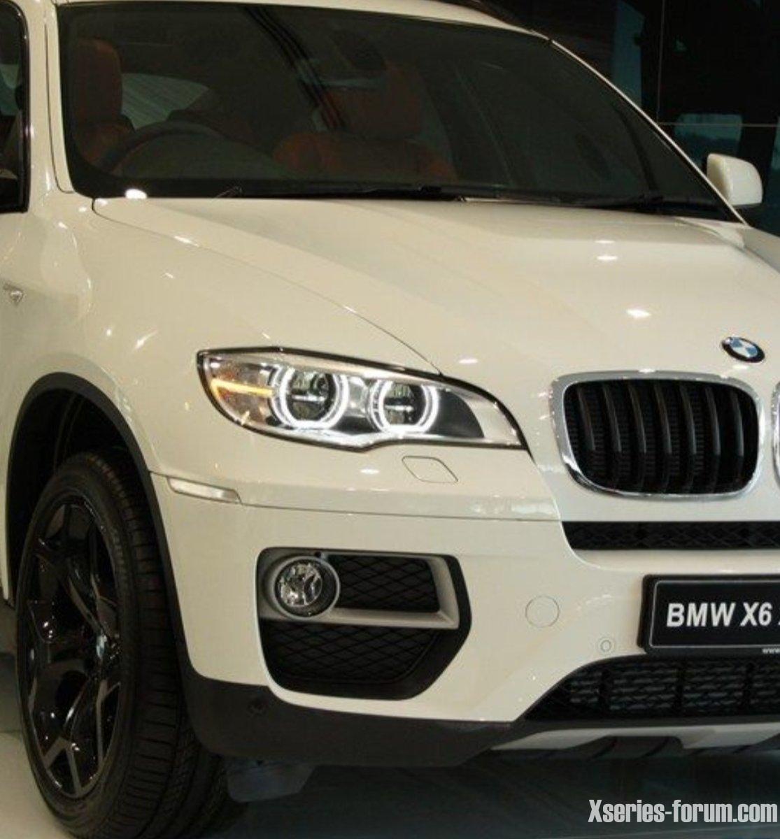

Curious if anyone has fitted any aftermarket LED drl's to an E71 or E70? I'm thinking the slim rectangular type, probably fitted in/on the foglight panel. I'd be open to other possibilities though.
Wiring may need professional help, given the complexity involved?

BMW did at one point offer a kit for non-DRL equipped cars. There wasn’t one for the E70/71 as those came with DRLs from the factory, albeit not LED. The slim, horizontal lamps went into the plastic trim close to the front fogs.
I can’t find them listed on REALOEM meaning they were withdrawn before 12/2019.

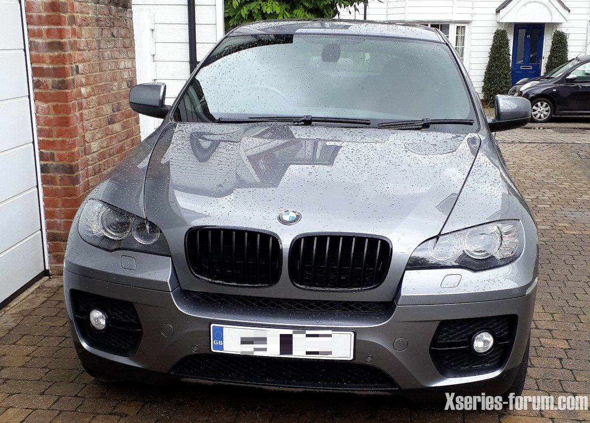

Those do look nice. I wonder how they'd look on the front of a pre facelift car? And how to integrate them into the loom ???

They'd look rather good on the facelifted model, underneath the foglight trim

Wiring might be straightforward, i think they'd look good on facelift models but not earlier models.
