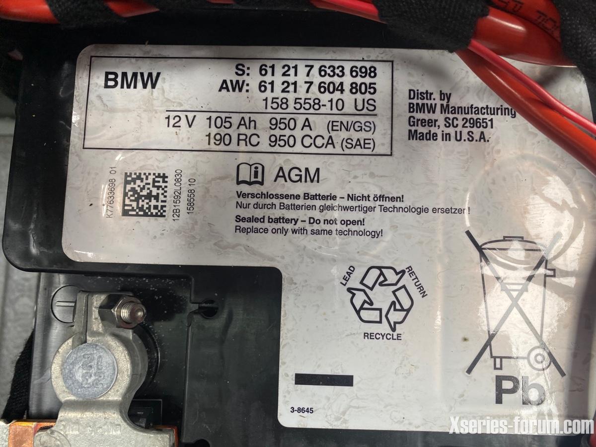

max
Posts: 197
(2012) X6 E71 40d Battery Specs / Replacement
Post by max » Sun Mar 05, 2023 2:40 pm
So I did a quick check to see which battery I already have in place and interestingly it is a 105Ah with 950 CCAs. Measuring the length also takes it close to the 393mm listed for the Bosch S5 A15 that I linked in my OP. You can just make out the manufacture date on the negative terminal, so I’m quite happy this is the original battery from factory - just a but surprised X5Sport your 40d came with a 90Ah from factory.
Our X6 is pretty much every option including the rear TV, so I wonder if that contributes to having a higher capacity battery from factory?
I’ll try and find a VIN checking service to see if it lists a higher spec battery in the spec list, incase this helps anybody with this query in the future

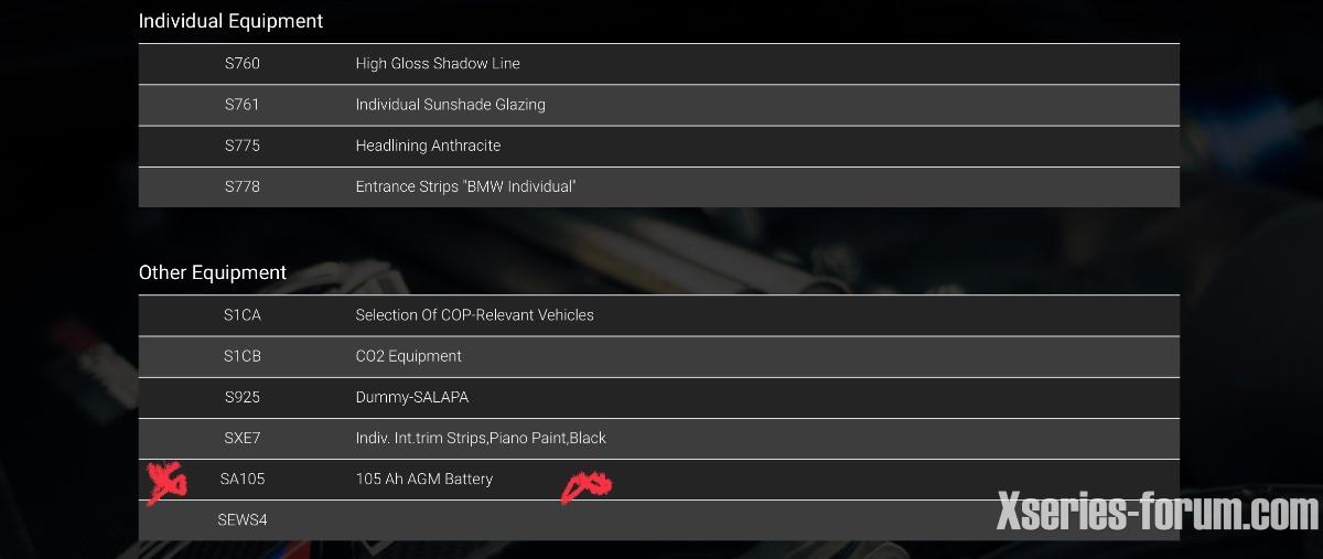

max
Posts: 197
Post by max » Sun Mar 05, 2023 11:26 pm
Everyday is a school day :) Spec list shows it as 105Ah - it must be the spec options which determine which battery you have from new. Hopefully coding will have a simple new replacement with the same capacities option.
I might get a battery price from BMW just for the :rofl:
