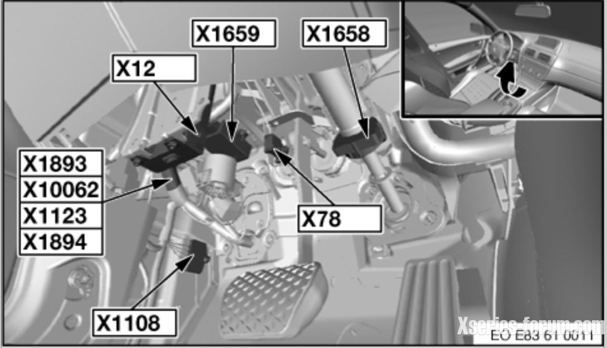

I’ve had a quick look at the electrics on a diagram, and most of what you’re seeing connects to plug X1108, drivers footwell, alongside others. The only image I can find is a LHD version, but it’s likely mirrored by a RHD. It’s an earth comb and grounds out horn, wipers, lights etc. could be worth a look to see if it’s loose or corroded.

Many thanks for that suggestion. I'll have a look tomorrow or at least be able to give the sparky a hint where to start. Just googling around shows symptoms of lights, wipers, horn etc all being linked to a bad body control module and used ones seem to be very hard to come by in SA. Hopefully not that but time will tell.

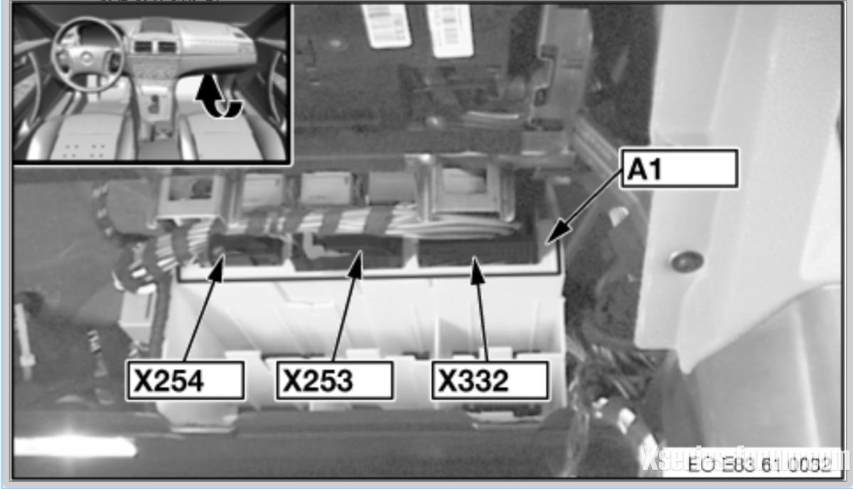

Module A1 - Basic Control Module is behind the glovebox in a rack…and everything seems to go to it as you’ve found. Hoping it’s an earth fault though - that’s easier and cheaper
. If it is that module then beware as there are different versions depending upon the options fitted to your car. If you haven’t already, then take a look at RealOEM and put the last 7 characters of your VIN into ‘Serial Number’ to pull up your version, then check according to options fitted. It will also very likely need coding to your VIN.

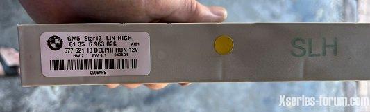

I took the car to a couple of auto electricians and they said it was the BCM so no point diagnosing or trying to find a short on a 17 year old car. I pulled the BCM out this afternoon and it has part number 61356963026.
According to our BMW dealers the part number needed is 61353454607. Real OEM shows this -

Am I right in saying that any of these superseded parts will work as long as I match the part number or should I limit my search to the first 3 part numbers as they are from 2005 onwards. From what i can find on Ebay the main numbers are the same but there are differences in the SW HW numbers. I assume these are different versions of hardware and software - will this make any difference? I'm going to have to find a used part as the new one at over GBP500 plus coding is a bit of my reach right now.

The late parts will work with the car and yes you should aim for the later part numbers. Going for an earlier version may work but those obviously had an issue or other parts were updated on the production line so needed a later version of the module. The date range is just for when that version was in use before being updated. The coding is very likely still going to be needed regardless. The module may contain things like VIN and mileage, both of which will need updating or you’ll see tamper dots (a lit LED dot) appear on the instrument binnacle.
When looking at used, ensure you pick the correct side - either LHD or RHD - as they appear to be different, and it will matter!
