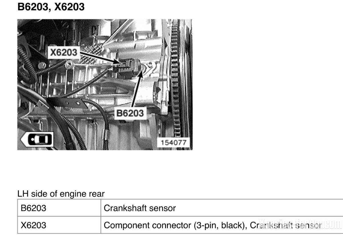

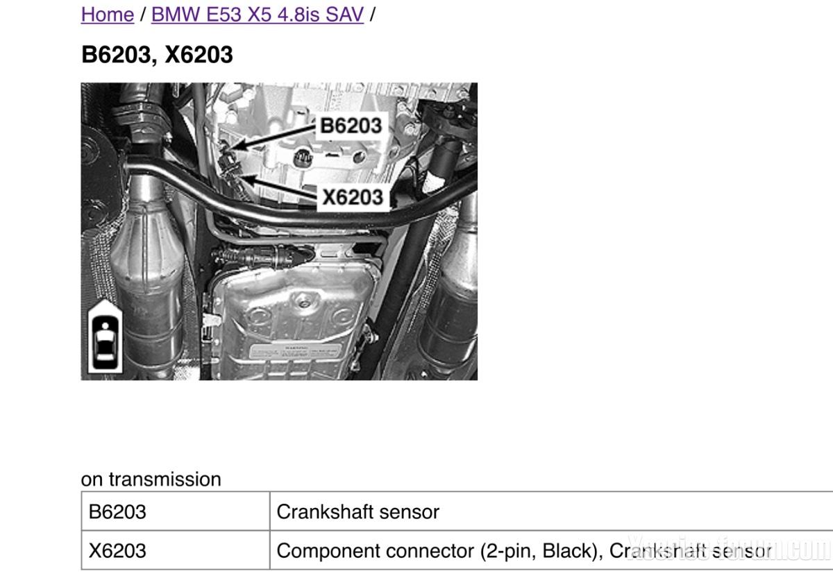

My apologies I forgot to mention it’s the 4.8iS! I’ve seen some contrasting information on the location, either access it from the engine bay and strip some parts down, or access from underneath and it can be a 15 minute job.

Post by X5Sport » Thu Nov 10, 2022 9:17 pm
Two possible locations is all I can find….
No instruction on changing them at all in the data I can access.

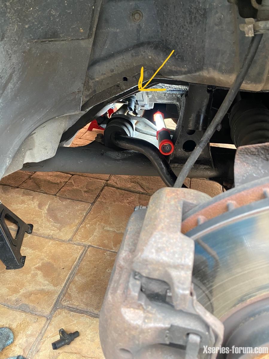

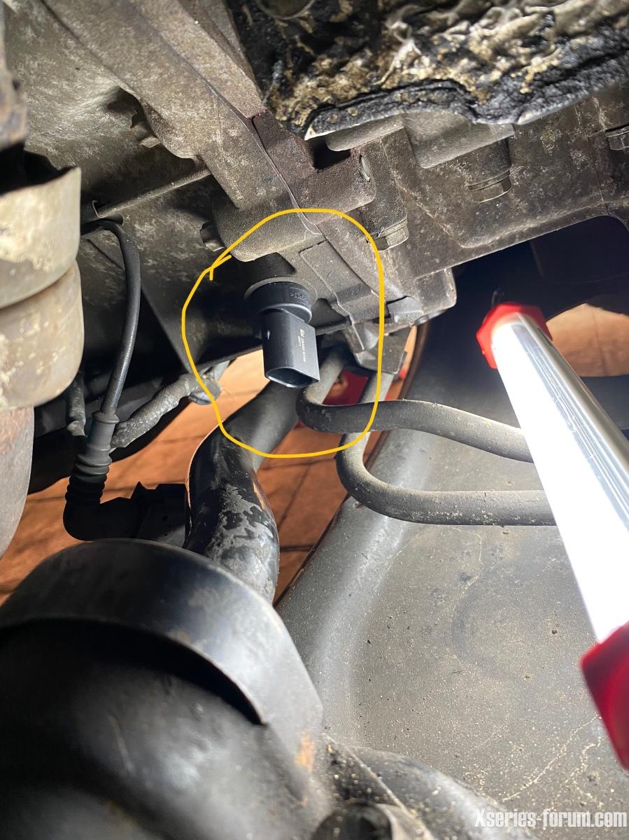

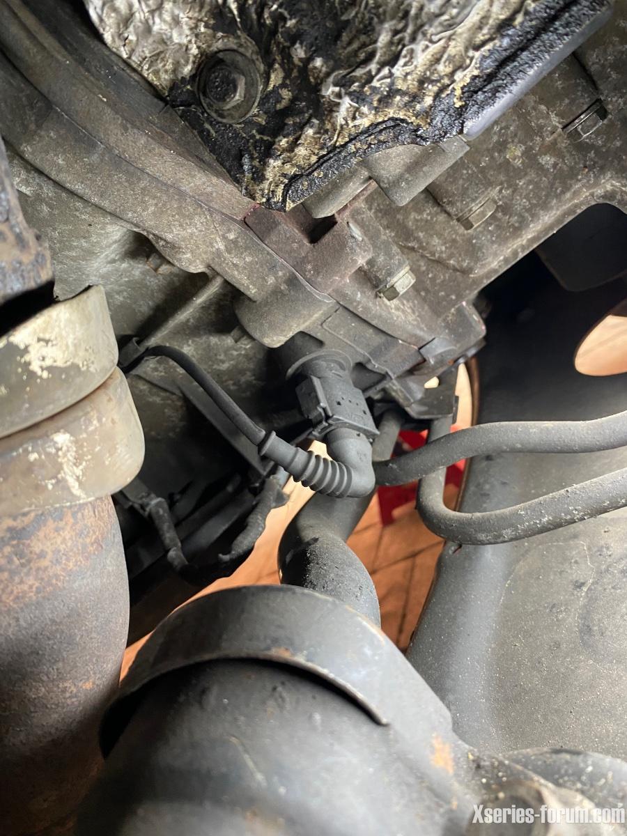

Post by WJord1 » Sat Nov 12, 2022 4:44 pm
Thought I’d post an update on the off chance someone else with the N62 needs to replace this part in the future.
Thanks @X5Sport for the guidance, to clarify the sensor is located on the transmission bell housing. I found the best way to access the sensor is to jack the car up, put it on stands, remove the drivers side front wheel and you should be able to see the sensor above the anti roll bar. I have included some (hopefully) useful images to show exact location.
The sensor has a metal retaining clip on the plastic plug, remove this, unplug the plug, then remove the 5mm Allen bolt holding the sensor in place. It should then just come out. Very simple once I found it! It is a bit fiddly with only a small space to get your hand into, but overall a very simple job.
