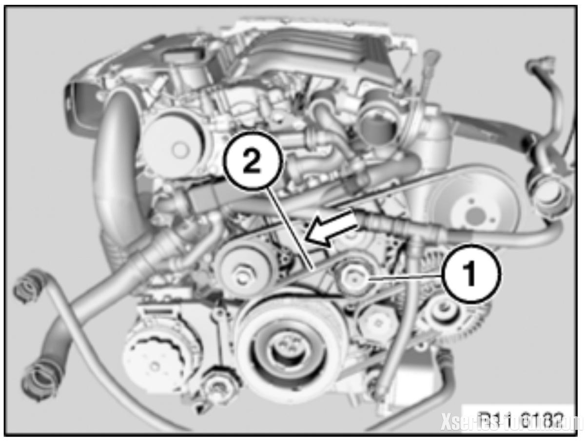

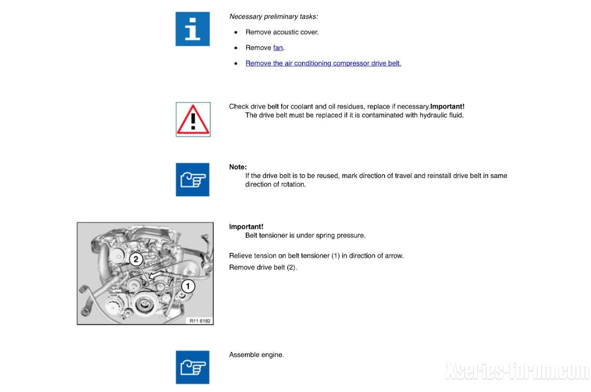

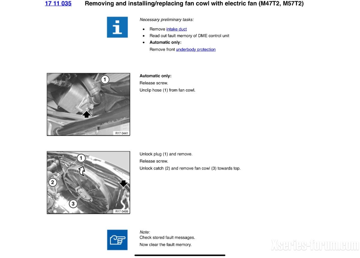

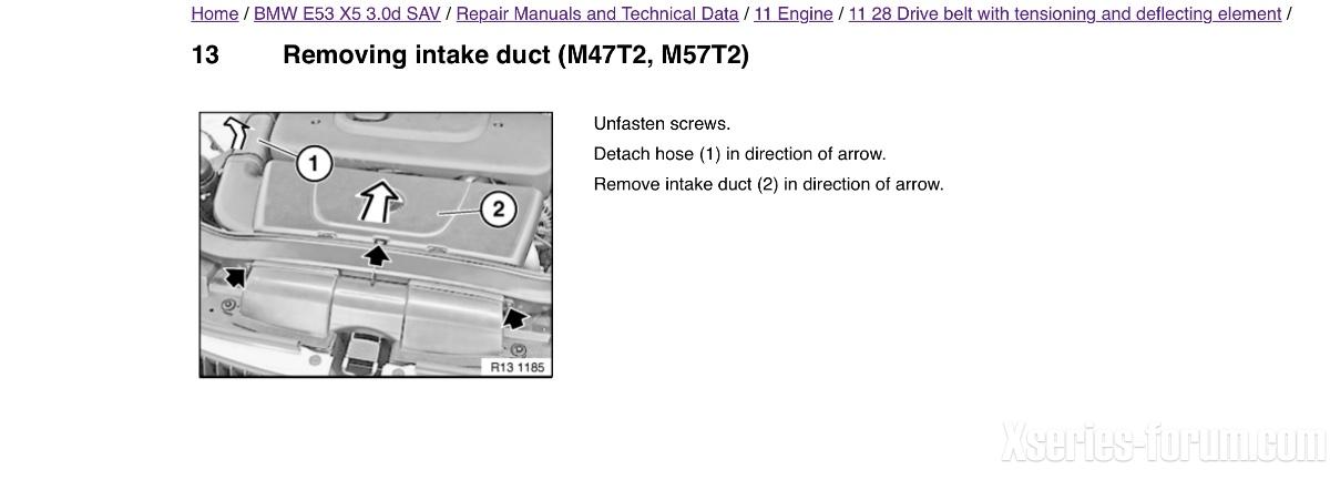

Write up with piccies……best I have and not terribly good resolution…sorry
The only special tool is the one for getting the AC Compressor belt on/off as you need something to stretch it over the pulley edge.
