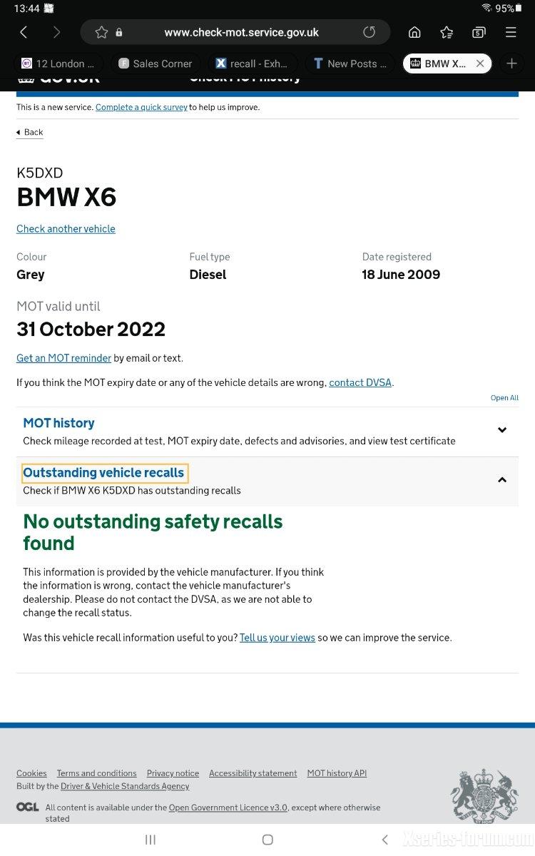

Nothing on mine so far 🤔
Screenshot_20220903-134412_Samsung Internet.jpg (96.43 KiB) Viewed 2395 times
