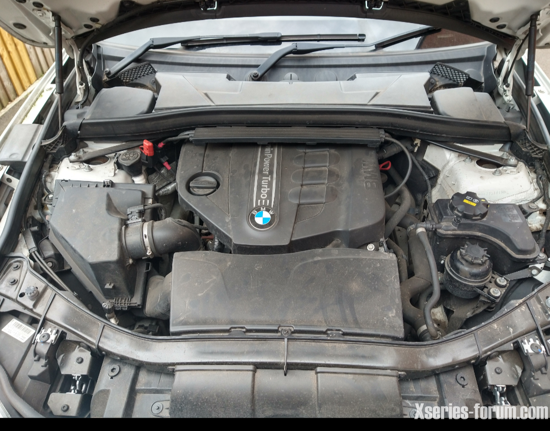

Hey pal,thank you again as always, I saw some vids about this and the level of work to change the battery made me laugh out loud. BMW are selfish buggers just want you to come back to them no matter what. I know BM's have many engine variations, I cannot seem to see my specific engine layout. If you look at the picture uploaded mine is different , most notably the air box on the left hand side compared to the right.
You don't happen to have the battery replacement procedure for this engine (2015 2.0 diesel

That’s the only procedure I found, and it doesn’t state the year/variant, just the model and engine. Sorry.
Battery Replacement - X1 Write up
Not a worry, appreciate the help, seems I have lucked out and have the easier variation (in BMW standards) to replace the battery, in the boot version.X5Sport wrote: Sat Feb 12, 2022 8:38 am That’s the only procedure I found, and it doesn’t state the year/variant, just the model and engine. Sorry.![]()
