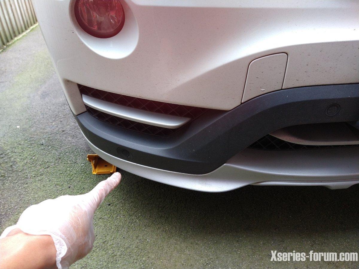

So finally got round to Testing out the sensors and my issue seems to be the front right if in the car or front left if standing outside the car (see pic). I know with electrical components on vehicles some things prefer to be OEM and others are fine aftermarket, so my questions are:

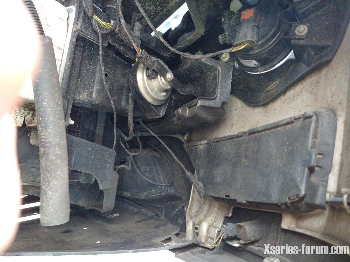

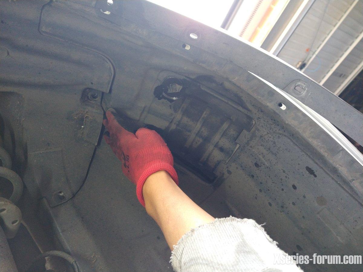

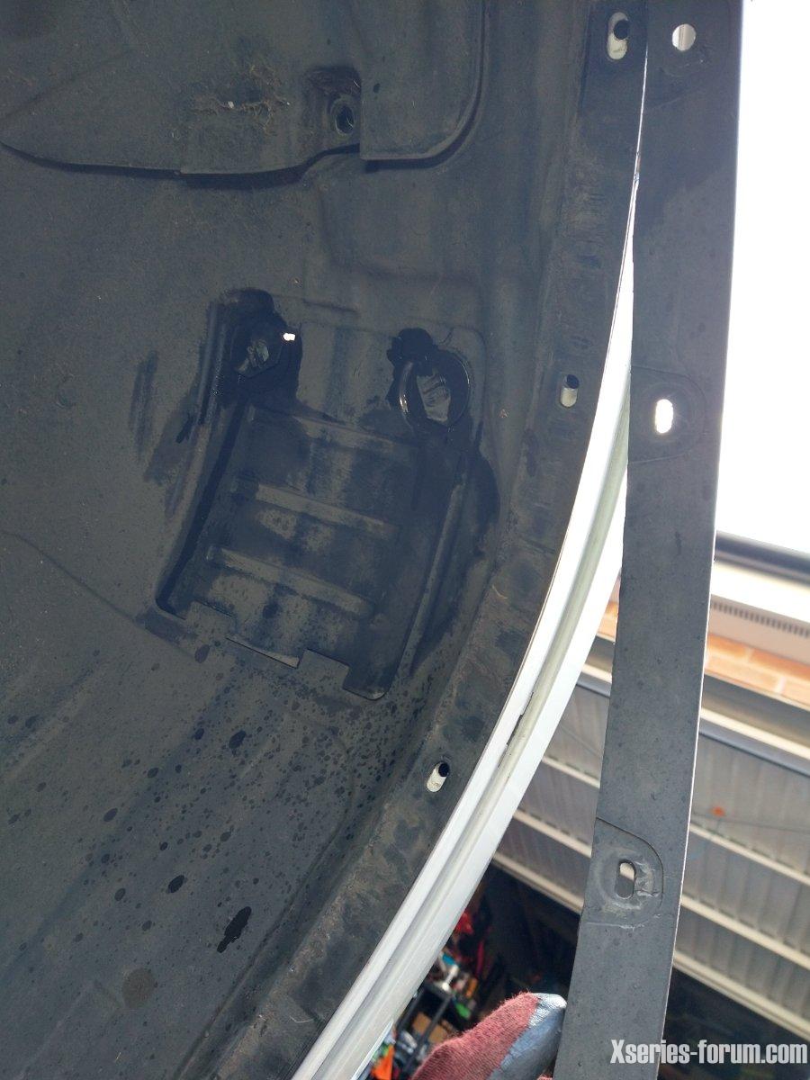

Just wanted to give an update on how things went, so finally go round to changing the sensor on my car, I actually replaced two sensors as one was gone al together and another I had a knock that side and it had recessed it in some. Whilst I did the whole job of taking bumper off and wheels to get to rivets, o actually did more work than I needed to. With the X1 e84, it seems you only have to remove , under tray , wheels to get out rivets, a PART of the wheel arch liner (see pic) and then you can simply reach in behind the bump and swap them out. On the side where I took a knock it appears the holder for the sensor has cracked so it does not sit well no matter how much I pus it from behind. Bit either way it wasn't the worse job, I really appreciatenall who offered help, I always like to research before I attempt any job and it's great when others help to aid this.
