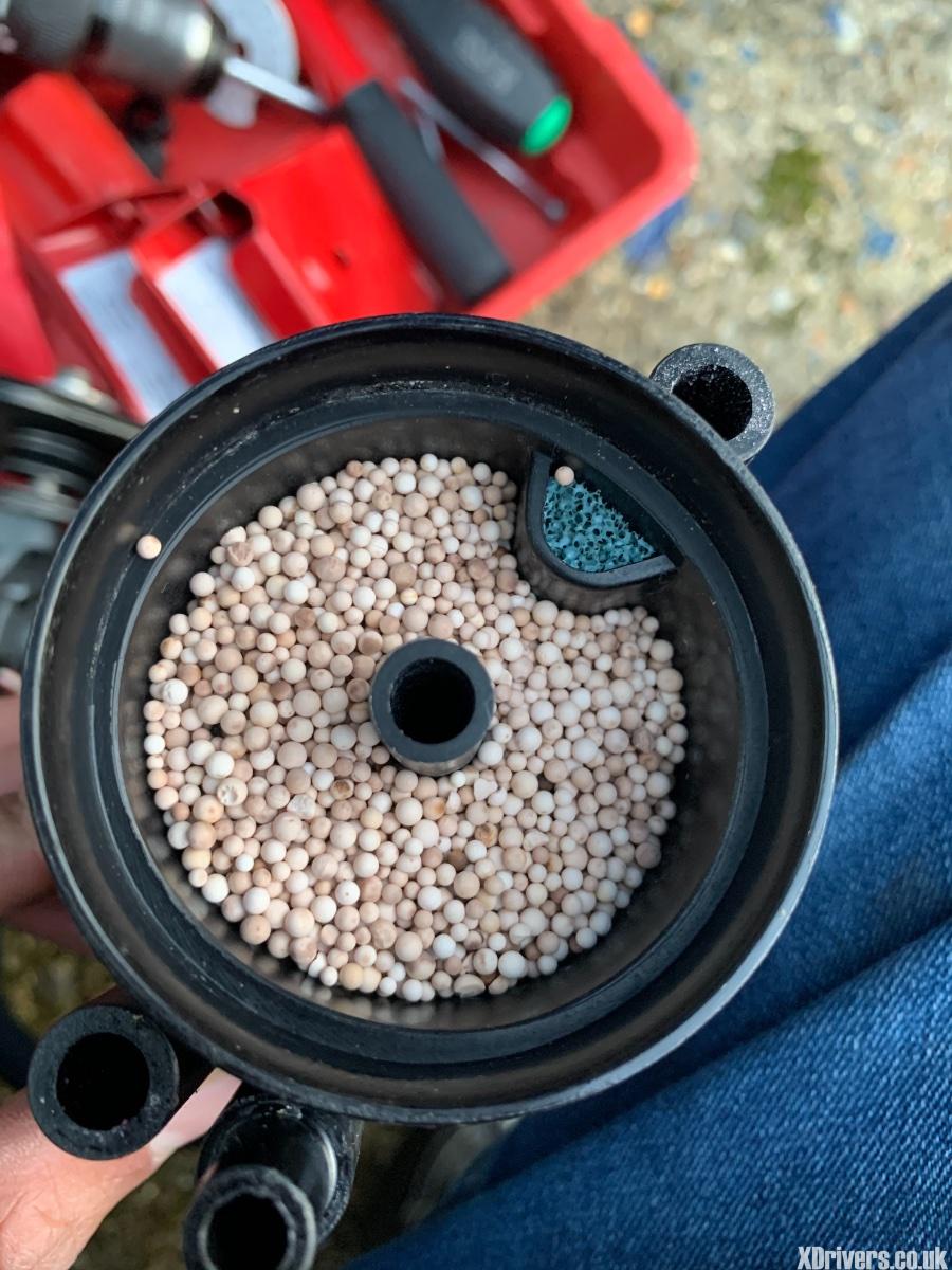

I did see this a while ago when strange things happen with air suspension , maybe some water has got in the compressor with all the recent rain and standing water ? seems the beads stick together and the compressor cant vent .Not much in the basic circuit usually bags a, solenoid , couple of level sensors and compressor

Thank you for a quick reply, I am planning to open the compressor tomorrow morning
I have also ordered the silica gel, I hope I get them delivered tomorrow during the lockdown in England.
Re: Air suspension having problems
It's definitely worth a look before blowing a few hundred on a new compressor as it is running and creating pressure , mine had a dent in the cylinder head where the piston hit it so was a bit terminal

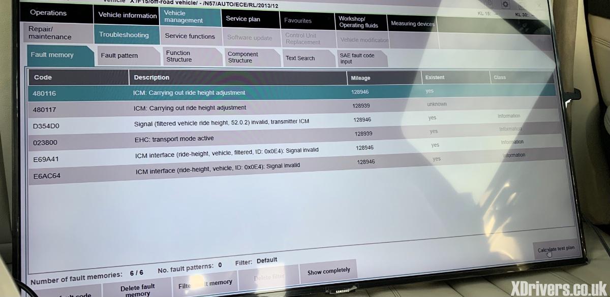

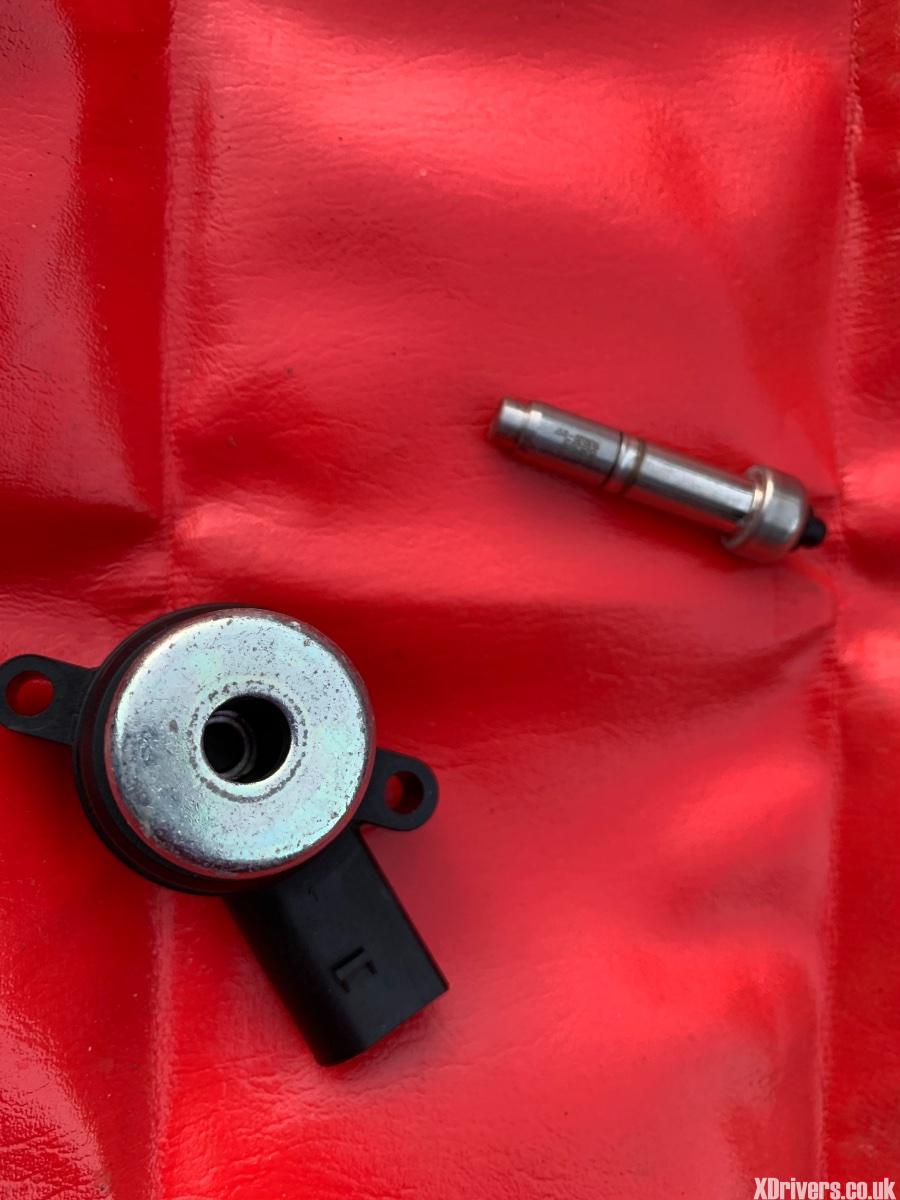

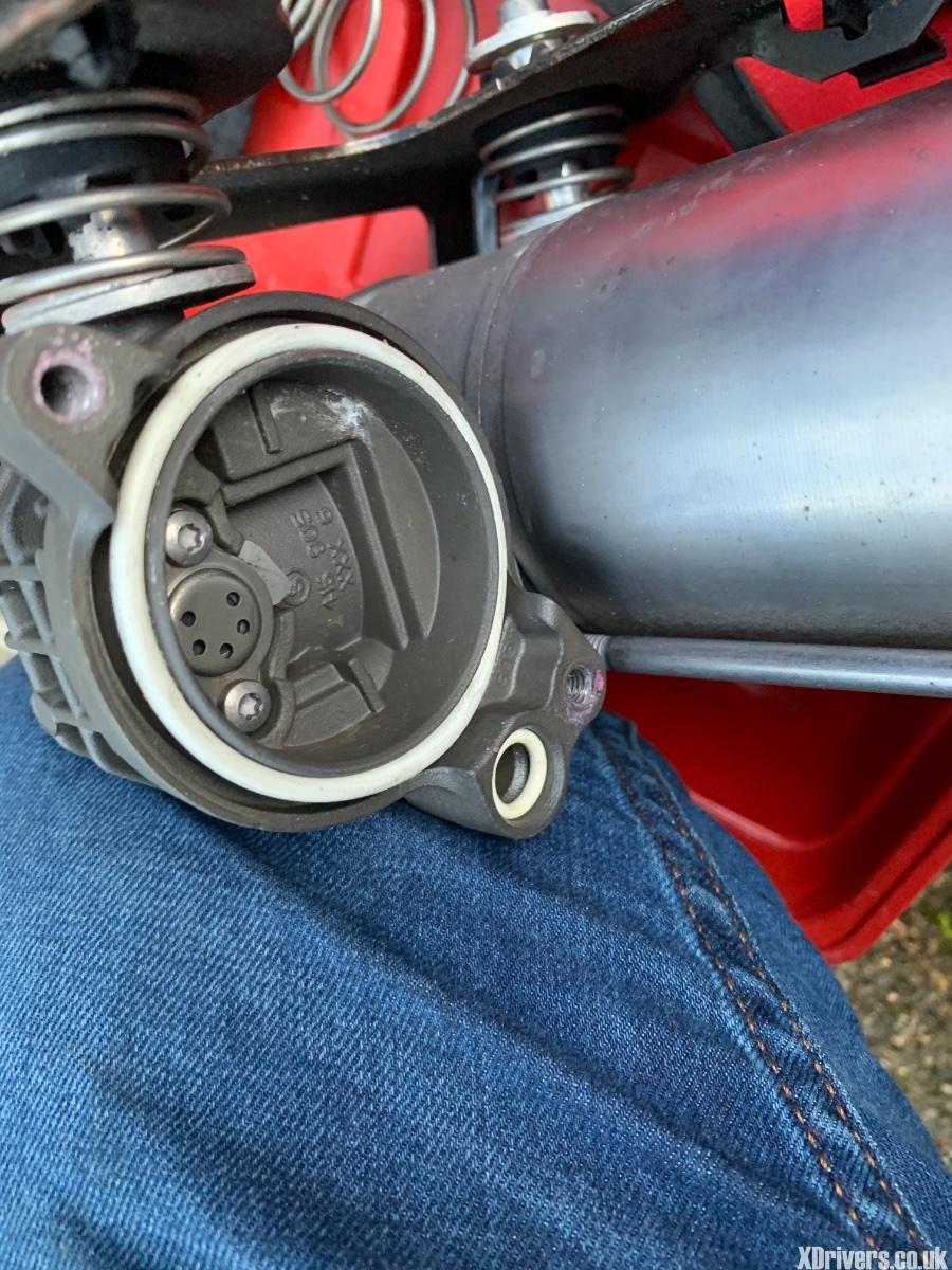

Ok so I ran the test on Ista D, strangely there are new codes please have a look in the pictures, I have also opened up the air compressor, there are no signs of moisture or any corrosion.
I put the air compressor back on however the vehicle won’t inflate itself, so I had to run the inflate
procedure with ista D, but and went on drive but again the rear is lifted and it looks ugly also the ride was very bumpy. I’m running out of things now.
Could it be the ICM unit? Or the VDC?
Please help me I’m sick of this car

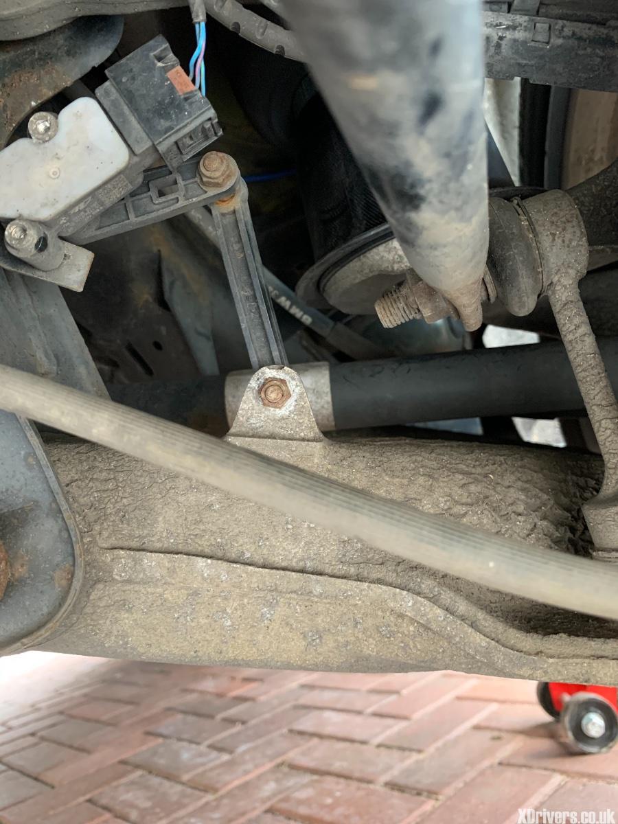

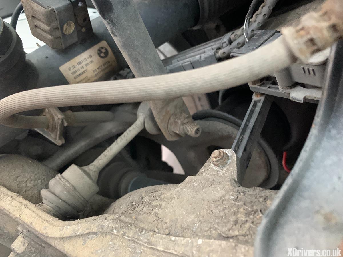

That looks fine to me ,It sounds like you have a control issue the system doesn't know where it is at , when you commanded it by software it just kept pumping as it isn't seeing the level so is lifting too high and too high pressure in the bags causing a very bumpy ride is that the issue ?
check that the link arms on the back level sensors that attach to the swinging arms has not become detached as that is what it would use to tell the compressor to start and stop pumping. If it has broken off move it and see if it pumps then with the key in and be careful where your hands are at !!!!!!!! If the compressor can be commanded to run it doesn't sound like it is the issue.
Id start with left rear by the codes ...
Is this a 2 airbag car with ordinary dampers not the electronic ones ?

Thank you Leslie for your reply, I have checked all the ride height sensors they all seems to be fine, have a look in the pictures.
I have also done the ride height calibration and reduced the numbers to 700mm on each wheel so the drive was good and the car is not lifting itself higher, however I’m still getting the “chassis function restricted” warning on the dash, so I connected the ista I’m still getting the ICM errors.

Why is Transport Mode on? I thought that was only used when the cars were being ferried from factory to Dealer. That places limits on the suspension controls. Just a thought.
So how do I switch it off?
- Posts: 18970
It’s a coding change normally done by the Dealer as part of the PDI. It’s not unknown for cars to randomly switch it back in again for no obvious reason when repairs have been done. Not having used the tool you have, I can’t say how it’s done but someone on here may know.
