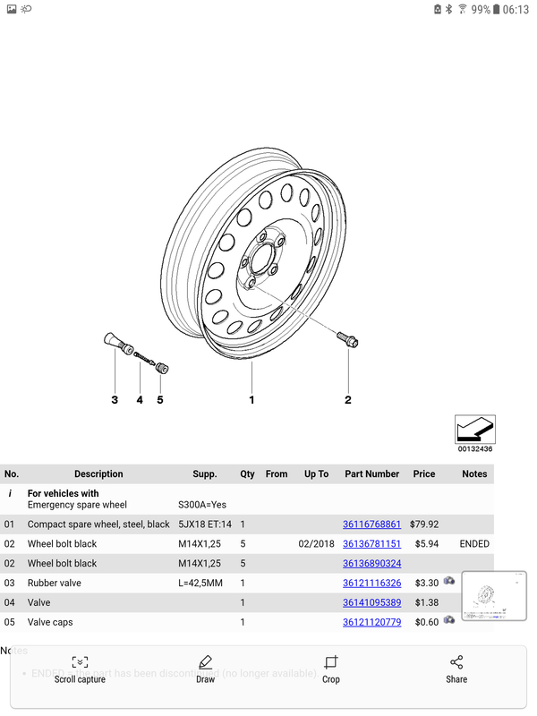

I am getting a space saver wheel rim but need a tyre and have found the land rover spec tyre is much cheaper and easier to get as the bmw one is an oddball size and scarce/ expensive .
X5 spec is 155/90/18 which is 1% bigger than 20 inch wheels
Land rover spec is 155/85/18 which is 1 % smaller than 20 inch wheels so neither are a perfect match.
Even on 21 inch rims the front and back are 0.7 % rolling difference going by tyre comparator from the factory.
The land rover one even has a higher load index can anybody see any issues ?
Most of the ones on eBay the tyres are about 13 years old for x5 wheels as they were never standard fit !

Hi Sapphireblack , I wonder if its even the right rim as the X5 e70 /X6 uses M14 bolts not M12 like other BMW's .did you actually try fitting it ? I had a similar experience myself ,saw one for sale and rang up myself a while back about a local X5 wheel advertised ,of course I couldn't see the tyre markings from the pics but was assured it was right ,well it only had like a 125 tyre on it when I asked for the numbers ,way too small to be x5 ! Of course they had bought it secondhand like yourself as unless you know otherwise most assume any one that fits over the brakes is fine but as we know for 4wd it just won't do !

The original wheel, with incorrect tyre i sold a while ago now but it was the correct rim, part number as below. I replaced it with a full set with jack, tools etc and the moulded tray. Better in every way but very expensive. Given the E70/71s fragile transmission and it being a one off (two off in my case) purchase i just paid up and bought the right rim and tyre.
The '85' tyre is 2264.1mm circumference, the '90' tyre is 2312.8mm. As you say its a question of 4mm down or up in ride height from the regular road wheels. This of course could be made greater by worn, low tread regular tyres arguably making the '85' tyre more favourable. I just went with BMWs edict to be safe.

Another possibility is a 19" alloy space saver from the 4.6/4.8 E53 with 155 80 19 rubber but the offset is ET40 instead of 14, though a spacer would cure that, but then its carrying longer bolts and the spacer and faffing around when you least need the hassle.
I actually have an E53 alloy space saver i keep for my Touareg, its super lightweight. An advantage for total laden weight especially if the vehicle is loaded for holiday trips etc. Accessing it though would be a pita on a cold or wet day, enter tyre strings as a back up to the back up
EDIT
Ignore all of this, centre bore size is wrong of course
only 72.6 on the E53. 74.1 all round on an E70 and front of E71
Fits a Touareg tho
EDIT
Fits a Touareg tho

I did notice some e53 had an alloy space saver but most seemed to be 17 I seems he seen listed being alloy I guess it was thicker in the bead area which is why they went to 19 to clear the caliper and as you say the offset is a fait bit off but given the narrow width This might not be an issue as the e70 is around 40 anyway
Centre bore often an issue on these good spot be too late on a cold wet night when it won't bolt up.

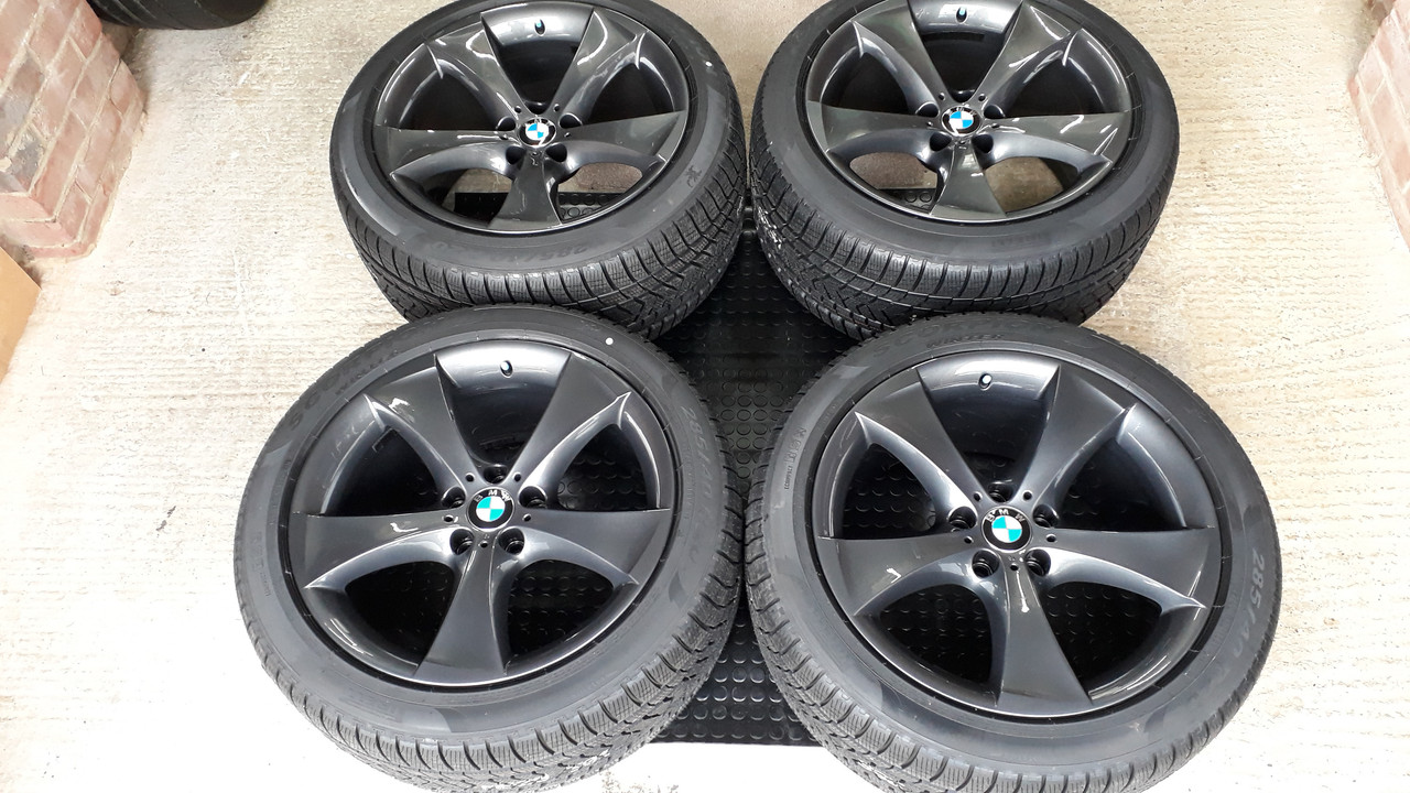

You may recall as i posted that i created an F16 type set up a while ago now, but have yet to use them

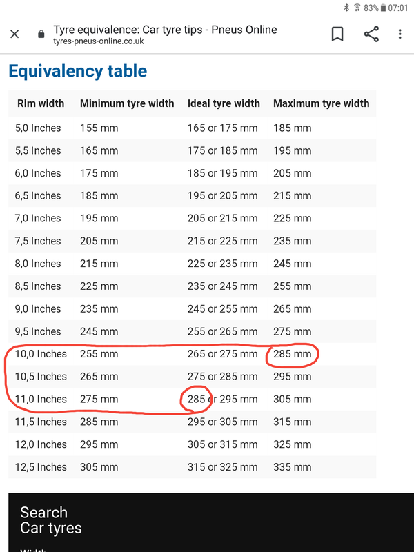

I bought a staggered set of 'easy clean' type 259 rims, had them refurbed in Orbit Grey and treated them to a set of Pirelli winters, BMW* in 285 40 20 all round. These of course are not run-flats so the space saver or gunk kit kicks in if required.

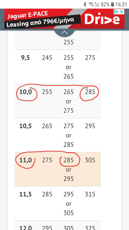

I was looking only today at some charts i saved showing permissible tyre/rim options and permutations which allowed me to be comfortable with my one size tyre staggered rims decision. It makes me wonder whether the same set up for summer use should be considered ? One size tyre all round would make life easier

Bmw fit a 325 tyre for 21's on an 11.5 rim so by your chart they are out of spec too

It does seem according to those two independent charts, that BMW push the boundaries with rear tyre sizes.
