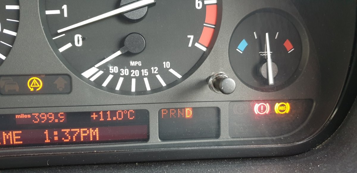

I have changed the rear left wheel speed sensor with a brand new Pagid brand, however the trifecta lights returned after some driving.
The speedo also stops working at the same time.
What could be causing this?

Re: trifecta lights
Assuming the sender is OK then it could be a wiring issue as in poor/dirty/broken connection at wherever it plugs in. Water ingress in the connection is a possibility - might cause a short or open circuit.
If it was working then I’m just brain dumping options at present.

Thanks for the reply.X5Sport wrote: Sat Mar 14, 2020 4:14 pm Assuming the sender is OK then it could be a wiring issue as in poor/dirty/broken connection at wherever it plugs in. Water ingress in the connection is a possibility - might cause a short or open circuit.
Clear the code and see what comes back?
The lights don't come on until the car reaches operating temperature. If it was a connection issue then surely the lights would be on all the time?
Once the lights come on, clearing the code does nothing - the lights remain lit.

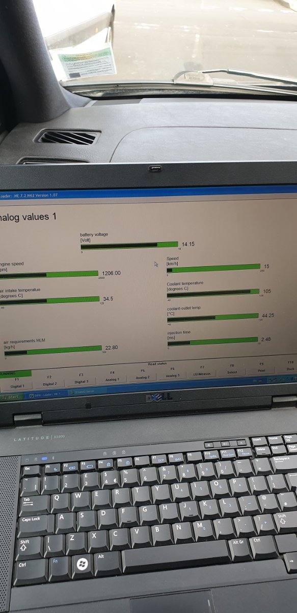

I have attached some more pics of INPA while moving, to see if it would help anyone diagnose this more specifically, and also a short video clip of the Live Data.

- 20200315_134556.jpg (130.97 KiB) Viewed 5294 times
- 20200315_134051.jpg (132.41 KiB) Viewed 5294 times
- 20200315_134049.jpg (125.85 KiB) Viewed 5294 times
- 20200315_133801.jpg (140.04 KiB) Viewed 5294 times
- 20200315_133733.jpg (138.33 KiB) Viewed 5294 times
- 20200315_132725.jpg (142.48 KiB) Viewed 5294 times
Re: trifecta lights and no speedo
The speedo is driven from that sensor and it is showing as open circuit. That will cause your speedo loss. Either the sensor is bad, or there is a wiring issue between it and the main electronics. It also drives part of the ABS and DSC hence having all three lights on.
