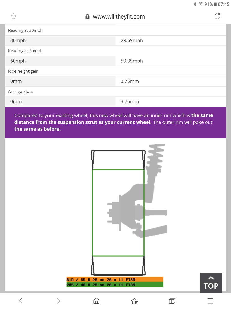

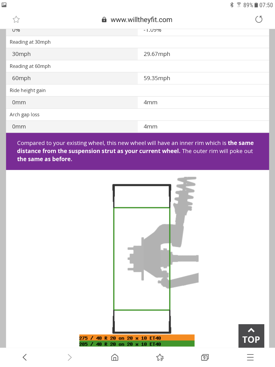

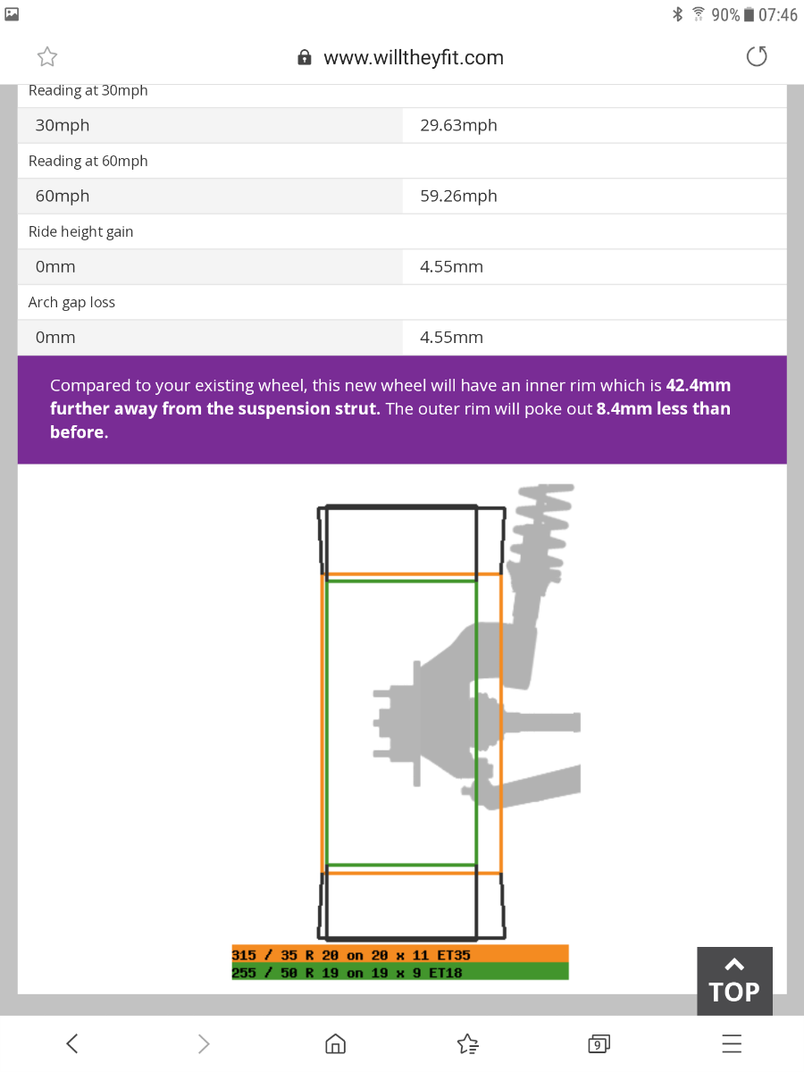

I'm getting bored and irritated with conflicting and inaccurate info from tyre dealers and not actually obtaining statements from BMW. They either duck the question or are incapable of producing an answer. So, here are some schematics demonstrating physical differences. This seems to immediately dispell one statement from yesterday that a 285 40 20 will be taller and upset the transmission. Well that can't be the case as BMWs suggested 255 50 19 is also taller by a very similar amount.
Here are BMWs 315 35 20 compared to their winter suggestion of 255 50 19, followed by 315 35 20 compared to a 285 40 20 on an 11" rim
Also the front comparisons, 275 40 20 > 255 50 19 and finally, 275 40 20 > 285 40 20
I think what this tells me is the variables here are pretty constant and near identical to BMWs only written suggestion of 255 50 19. I think i'm happy to 'gamble' on * Pirelli winters of 285 40 20 all round as it's 'square' and almost the same nominal ride height gains. On non RoF Vs RoF even that may not actually matter, and once again lets not forget the 285 40 20 * Pirelli winter non RoF is BMWs actual specification for the F86 and possibly others. The only difference is a half inch wider rear wheel on an E71. A 285 tyre though is fully endorsed for use on an 11" rim

sapphireblack wrote: Sat Sep 14, 2019 8:26 am Here are BMWs 315 35 20 compared to their winter suggestion of 255 50 19, followed by 315 35 20 compared to a 285 40 20 on an 11" rim...
Some great detailed info there, but missing, what I think, the most important calculation of whether 10J 285's and 11J 285's would create a different rolling radius.
Thankfully:
Unless I'm missing something, that's a win :thumbsup:
