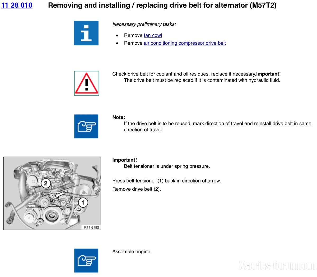

Belt tensioner … says you need to do this if you want to change the water pump. Hoping this might be the right engine/version. (M57?)
If the AC one also needs to come off that needs a special tool to put it back. Piece of cake really … not!

Thank youX5Sport wrote: Fri Feb 25, 2022 4:16 pm Belt tensioner … says you need to do this if you want to change the water pump. Hoping this might be the right engine/version. (M57?)
These modern aircon belts are "stretch belts " I just replaced on on our focus as it's in front of water pump/alternator belt like most nowadays.There is no adjuster on these and no way of taking the tension off , it just says cut it off ! (brilliant design ..not) You're right putting these on without the tool is a right faff it took me about 20 mins , the tool is little more than a spacer too allow the belt to ride over the grooves till it snaps on as you rotate the crank pulley . I used a piece of card on the grooves but with limited access it wasn't fun
