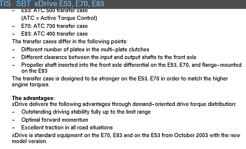

I think I'm going the other way on this. I've been digging in to TIS tonight.
First a description of when cars became equipped with xDrive as standard:
This matches with the parts catalog note that the Dex III oil is only for the E53 up to 09/03 which are the pre-xDrive models.

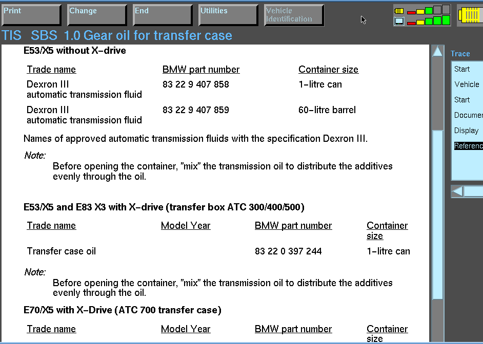

Then under SI fluids there is an entry for the transfer box:
That's pretty much convinced me that JamieX5 is correct and 83220397244 is the stuff to use. I think maybe the parts guys don't pay too much attention to detail or maybe they are using RealOEM :noexpression:

Greg - if you have a facelift car with xDrive (the ATC500 transfer box) then I'd get the fluid changed again. The local dealers parts guy called me back today and said he'd checked out the service information and agrees that 83220397244 is the correct stuff for this box.

Honestly, that is not the correct information. As I showed you above for cars with xDrive 83220397244 is the correct fluid. After showing them the service bulletins my dealers parts department agrees too.
Look in BMW's official parts catalogue. It has a note that the fluid you describe is only for cars up to 09/2003 without xDrive.
You don't have to listen, if you are happy with what you have then fine I'm just trying to save you and others from potential early clutch failure in your transfer box. Who knows it might work fine and they are just trying to sell us overpriced fluid but at a couple of thousand pounds for a new transfer box I'd rather not take the chance.
