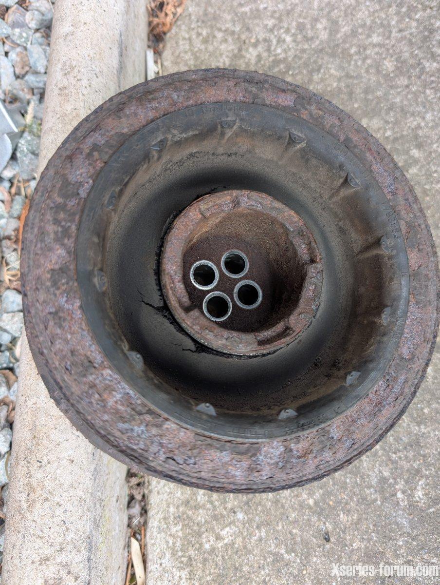

Update: Ok, removed the electric fan and took off belts. This revealed the crank pulley to be loose and spinning freely (without the crank shaft!), guessing this is the root of my steering problems.
Next task, figure out how to lock the crank to remove the 4 torx bolts to remove the pulley!

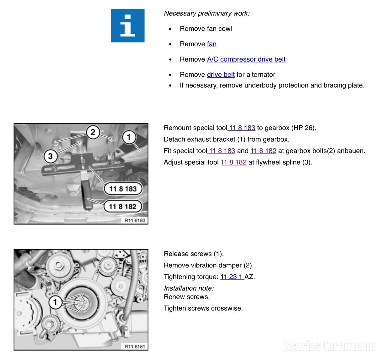

BMW of course use a special tool that attaches as below (for HP26 auto):
Posts: 19167
2010 E70 X5 3.0d - Power Steering Heavy
Post by X5Sport » Sun Jul 06, 2025 2:46 pm
Torque specs:
11 23 Vibration Damper Tightening Torques
1AZ Torsion damper to crankshaft
M57TU M10x86 Replace screws
1st jointing torque 20 Nm
2nd angle of rotation 120 °

Why do BMW and easy never go together....... :headbang:

Post by Sm[]key » Sun Jul 06, 2025 4:42 pm
So it seems my Spidey sense was correct with it being the crank pulley!
I don't believe in BMW 'Special Tools', managed to lock the flywheel from undercar with flat head screw driver (Two Man Job), et volia!

There’s pretty much always a way around ‘special’ tools. All you need is a bit of ingenuity - or in your case two extra hands and a large screwdriver :D
I think we can safely say that one is well….worn out (being polite).
Could well have been the root cause for your other issues too?
