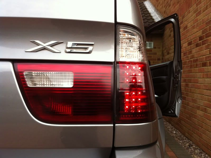

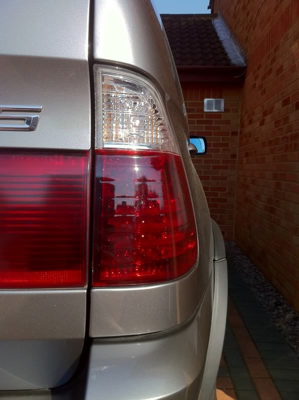

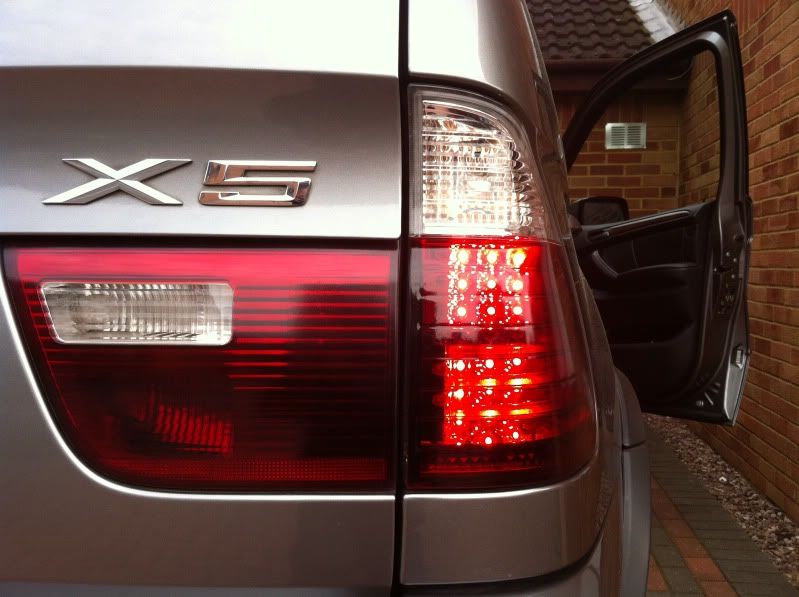

Many thanks go to forum member mccabema who sold these to me. I liked the fact they weren't full price and the resistor mod had been done to them (stops them flashing when in use). Had no idea how they lit up either but not bad.
When I got them, they were SUPER bright and I could see motorists behind me being dazzled. I wouldn't like it happening to me so I looked to reduce the huge light output. Short of fitting another resistor, the worry of where to put it, it melting/burning other parts of what is now a very tightly packed set of side compartments, I went with the spray option.
Some shots - no lights, with side lights and with brakes. Camera likes to ruin the shots but you get the idea - at night/low light levels they are a much better compromise, if not still a little bright but I didn't want the rear lens any darker...

Very nice. How do they work with the brake force display function? Or is that now non-functional?

I wish! This is an E53 X5Sport - we don't have that luxury! Brakes on and brakes off is all we get! :rofl:
They're simple/no fuss type, exactly how I like my mods. In this case, look twice and yuo still wouldn't know they were a mod, unless you're mad like me! :roll:

Errrr, I got BFD on my E53. At least, that's what it says in the book. It brings on a second brake lamp above the normal one when you absolutely stand on the anchors. Could it be that's why the lamps you have were so bright? If the BFD had not been implemented properly then it would be all or nothing?

These ones are no more than 2 square patches of 3 by 3 LEDs one above the other. I have seen the light emitted through them as side lights and then a brake lights. Under braking they get 'brighter', no additional LED's.
My originals have only two bulbs and indicator. Are you saying under normal braking only one of those two bulbs would come on and BOTH under heavy braking? As side lights they both come on of course.

Yup, that sounds right. Both bulbs in the red zones should be twin filament with both low brightness filaments (4W or whatever, I can't remember) as tail lights, the lower 21W for normal braking and the upper 21W one only coming on under very heavy braking.
Foglights are inboard on the lower tail gate. I guess the idea was to keep fog and brake lamps well separated so following drivers don't miss the brakes and should not miss the additional light output in an emergency.

In that case in these units both 9 LED squares light up under braking. Could explain the additional light.
