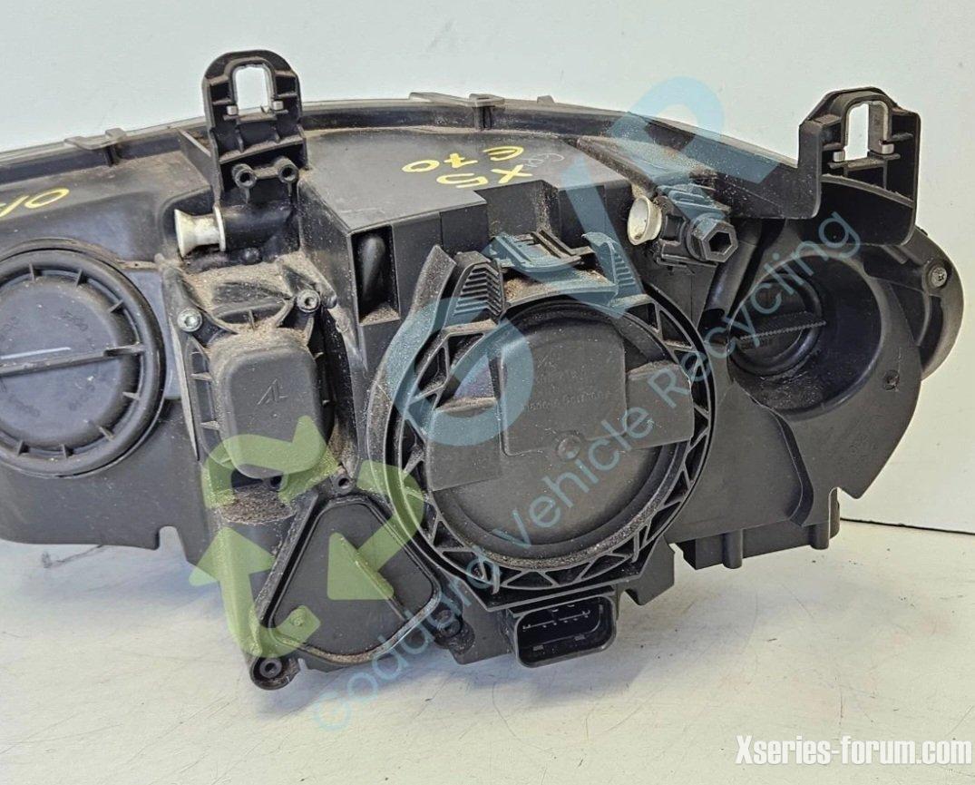

Headlights for sale show two ports which mine has, .but when i open the smaller on my car, all i see is the back of what i assume is an H7? Where is the H8 located?

My understanfding has always been when your sat behind the wheel Right hand side (Drivers side UK) and Left hand side (Passenger side)
The picture you posted showing the Bulb is the passenger side (left) headlamp and that is the H1 lamp, the other cover will have an H7 lamp behind it. The picture of the back of a headlamp unit you can see an oblong cover held in place by 3 screws between the two round covers behind that is the Parking/Halo lamp.
That is just about impossible to get at with the Headlamp unit in place (or I found it so) My local Dealer quoted £87 + VAT for just the parking/Halo lamp

Yes they all do but sadly they are wrong on two counts (1) the H8 is the halo lamp on Xenon Headlamps (2) I think BMW must have a special Technician with really skinny bendy arms and fingers
On my headlamps and it seems yours my fat old fingers just couldn't get at the H1 lamp without them being double jointed and 2ft long with a grip like King Cong
The inner H7 Lamp I found impossible to reach without taking off the wheel and the inner arch liner then getting to the cover for the Parking/Halo Lamp proved that the whole unit has to come out
